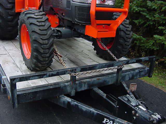

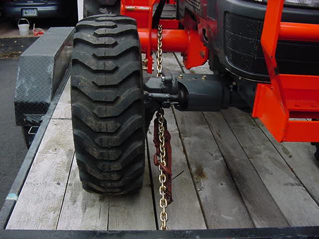

Rory - I had problems the first time I hauled my L3130, couldn't find good place to chain to on front axle, without damaging something. Attaching 4 pics showing how I did it - used the Clevis on the rear as Papa Perk recommended, but tied the front chains around the axle per pics. Plan to use the bolt on d rings in the future as Papa does. This will give me angle ties on the front rather then the straight pull shown.
A few years back, I chained the Bush Hog to the trailer, rather then the Fergie I was using - BIG MISTAKE. Not a good idea to chain to the attachment.
Have fun.
penokee /forums/images/graemlins/smile.gif

Picture 2 - front tie down
