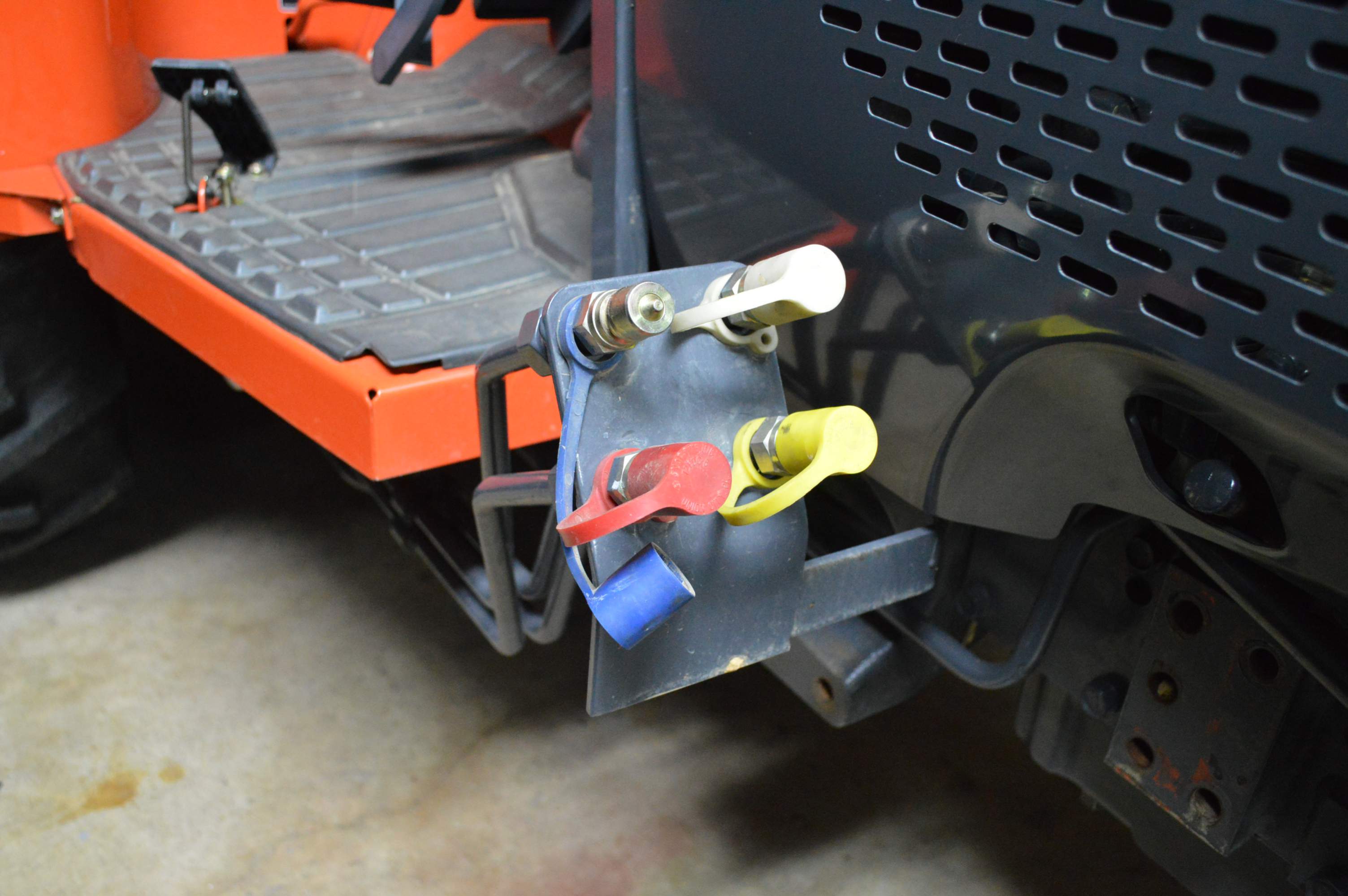

I have a 3240 with NO front end loader-- I am wanting to use the factory outlets for the front end loader to work a grain drill wheels- my buddy is going to pay to have the hoses made. What I need to know is what size are the fitiings (female) that plug into the factory out lets? and which ones to connect into to -- to lower and raise the wheels.. Power in and relief outlets.. Here is the pic of the factory connecters-- we are going to hook male fiitngs up to a trex drill- I understand those are a "universal " John deere fiitings is correct also?
1. what size fittings do need to fit a kubota 3240 (female)
2. which of the 4 connectors do I nedd to hook up to -- to lower and raise the wheels on the the drill?

The female coupler is a Pioneer 3/8 in. ISO B Interchange Coupler, Kubota/John Deere Tractors. If you go to TSC's website and search under 3/8 iso b coupler, it should come up. It's the coupler I used on my L3540 to make a pressure gauge and has a product SKU of 1820160.

Awesome thanks--- do you have any ideas which 2 colors I should hook to?
