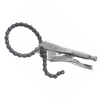

I have had luck as a last resort using a chain vise grip. You can really snug it down and apply some elbow grease if you lock it down near the base of the filter. I use it for all kinds of stubborn pipe work. Good tool to have...(can't never have too many tools and books)!
