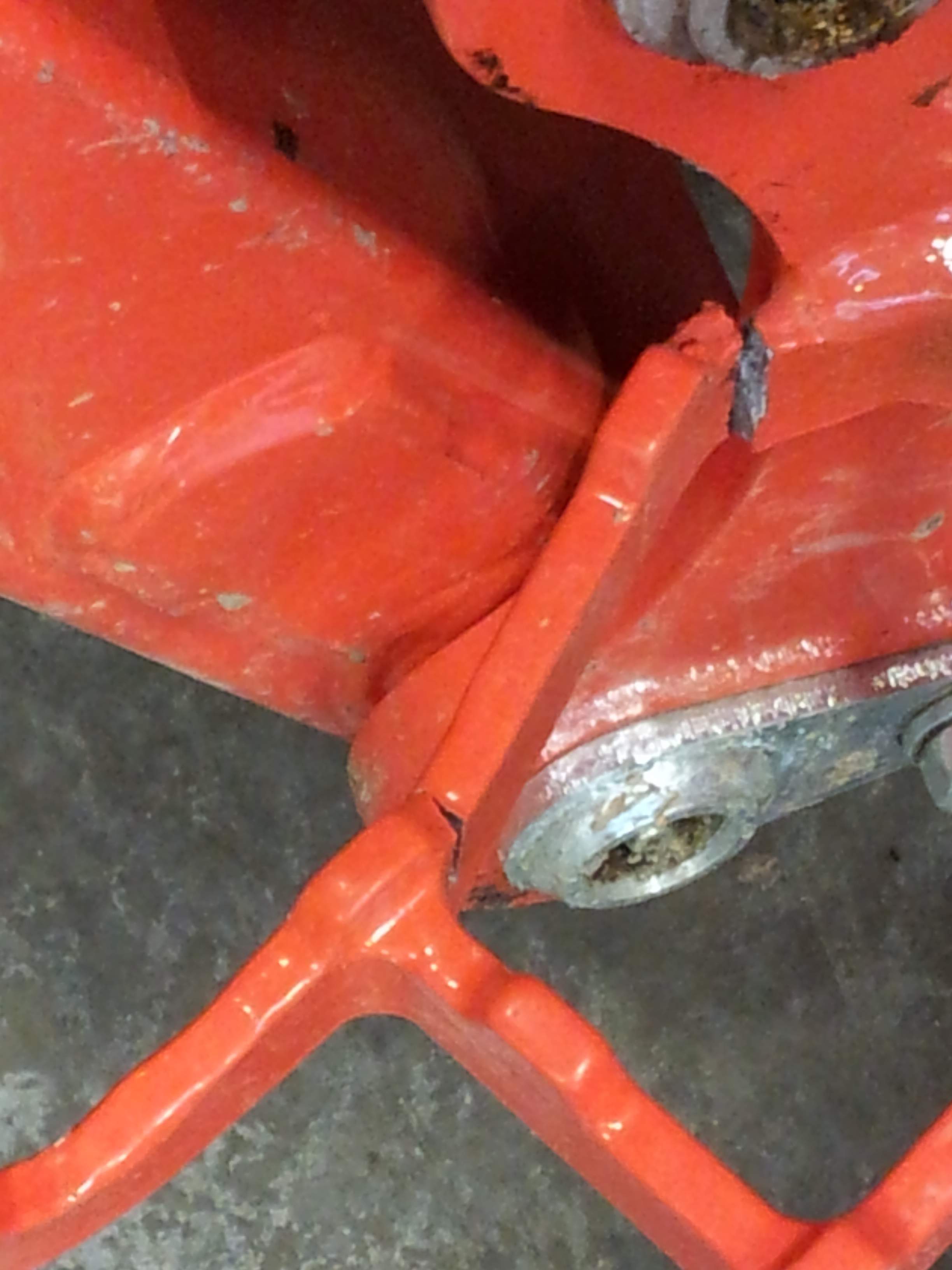

I was out digging / pulling stumps today with my L3200 Kubota w/ the Kubota 7'7" backhoe. After working for several hours I went to get off the hoe; stepped on the assist step; and almost fell. Obviously, at some point I must have set the stabilizer arm on a rock or something as it was broken in a couple of spots. So, now I need to fix it or replace it. The metal doesn't appear to be high quality steel ... more like pot metal; which would explain why it fractured the way it did. Has anyone seen a good alternative or have a suggestion on how to upgrade the backhoe steps? The hoe only has 20hrs on it so I want to do something that is good looking as well as structurally improved.
Thanks for your help.
Mark

A pic. would help. Maybe it can be replaced on warranty?
   / Kubota 7.7 Backhoe broken step #3
pictures? sounds more like manufacture defect possibly. doesn't matter what company, things do get through.

I'll post a pic tomorrow ... should have probably waited to post this question until I had one to attach. Sorry.
   / Kubota 7.7 Backhoe broken step #5
Just get yourself some 1" thick structural floor grating and with a little cutting and tack welding you can make a duplicate shape to weld on it. That is what my backhoe steps are made from.

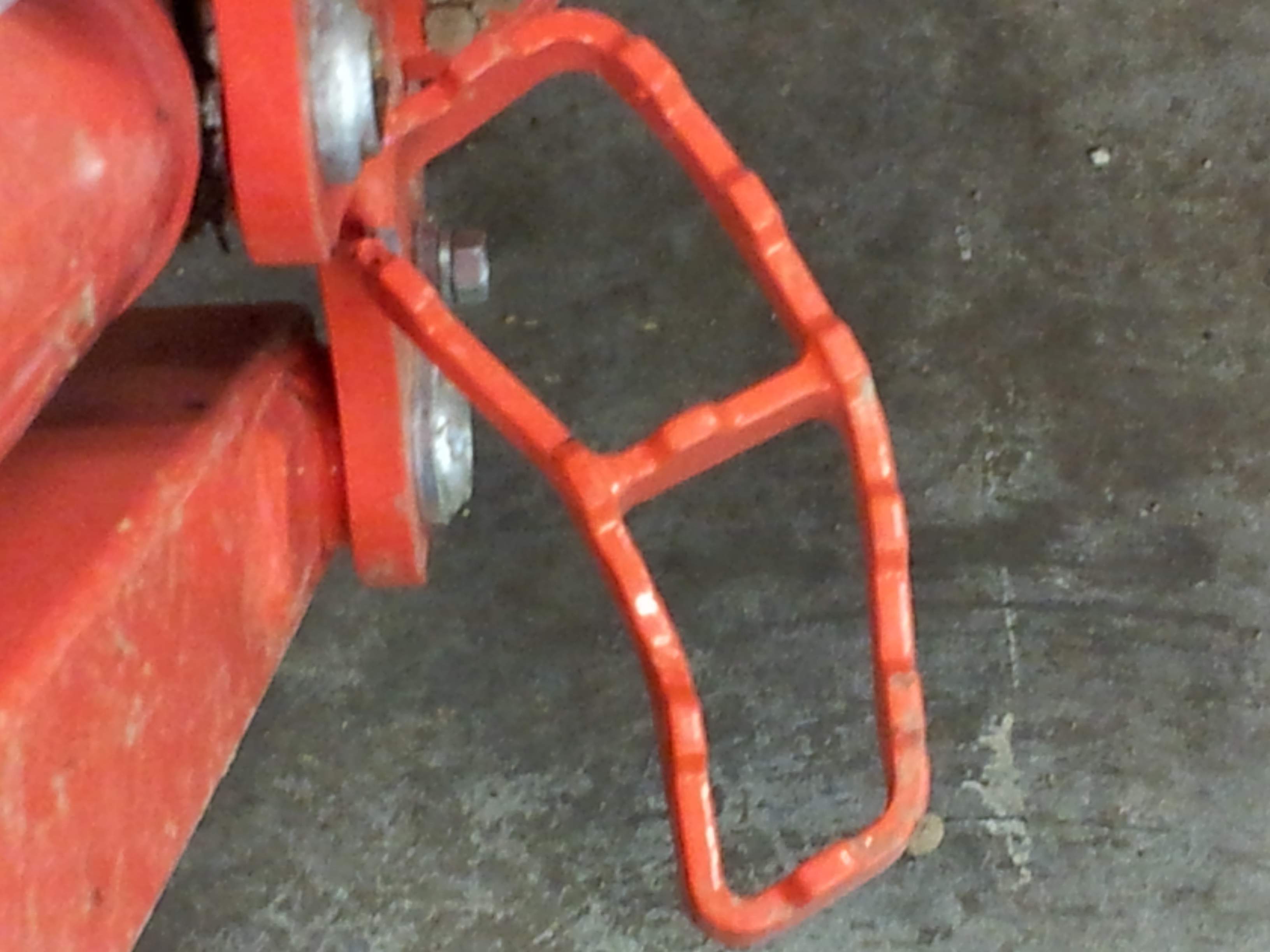

2014-07-12 07.24.23 (2).jpgThanks for the replies. Structural floor grating is a good idea ... I'm just not much of a welder. I will also check with my dealer regarding warranty possibilities, but I doubt of that dog will hunt. Here are a couple of photos.2014-07-12 07.24.34 (2).jpg

I would just bend it back into position then have someone weld it. I can not think of any way to improve it. There is no better place for the step so the manufacture had to put it there.
   / Kubota 7.7 Backhoe broken step #9
As I said, get some structural steel floor grating, cut out a typical section (it doesn't need to be rounded, square would work) and weld it to the same location after removing the Kubota original. If you don't have a welder, most welding shops would have some grating and could put a new step on pretty quickly.
