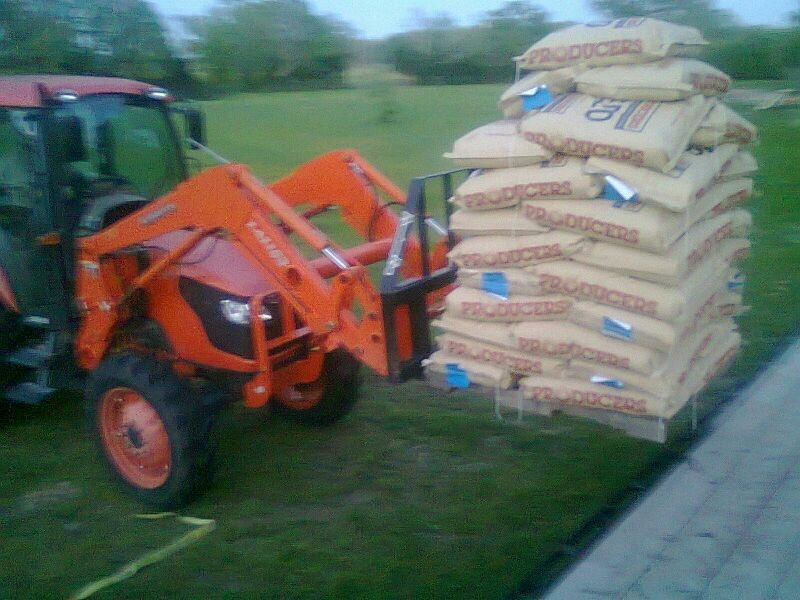

Most of my work is done with forks on the FEL. It will lift an amazing amount of logs and stumps (with the proper ballast of course). Gathering and piling brush is also easily done. But these jobs could be done with almost any 50+ HP tractor.
It excels in dirt work such as plowing, discing, harrowing, box blade work, back blade work, and ditching. Bush Hog work is easy as well. Check my signature to get an idea of the kind of stuff I do.
Can't say there are any major dislikes.

Last summer when it was real real dry I had no grass to shred so to stay busy I dug a small stock tank out in my pasture with a boxblade and the FEL. The 7040 handled it with no problem. The dogs really love having a swim on hot days.
