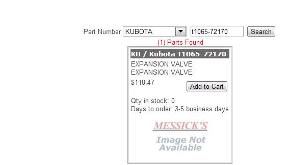

Would like to know if anyone can tell me where the expansion valve is located on L3430 Kubota
   / Kubota AC repair #2
Look around and see if anything that looks like the images in the attached are near were the lines enter the firewall (Evaporator Area).https://www.google.com/#q=picture+of+auto+expansion+valve.
A lot of the late model cars and trucks do not have independent expansion valves, they are built into the receiver drier.
GM and some other manufactures have switched to a Orifice Tube. The Orifice tube is inside the high pressure line where it connects to the evaporator. Orifice Tubes and Expansion valves... auto A/C diagnosis, repair & troubleshooting help. A good description and image is available in the web link.
Auto parts houses sell Orifice Tube Removal tools. A pair of needle nose pliers can also be used. Be careful if you are trying to remove a Orifice Tube. They like to break off easily.
   / Kubota AC repair #3
If you go to Kubota parts website click on your tractor model,click on AC,click on schematic (N10500) which is evaporator schematics ex valve is parts key #040. Evaporator is accessed on tractor by raising roof and removing a cover
