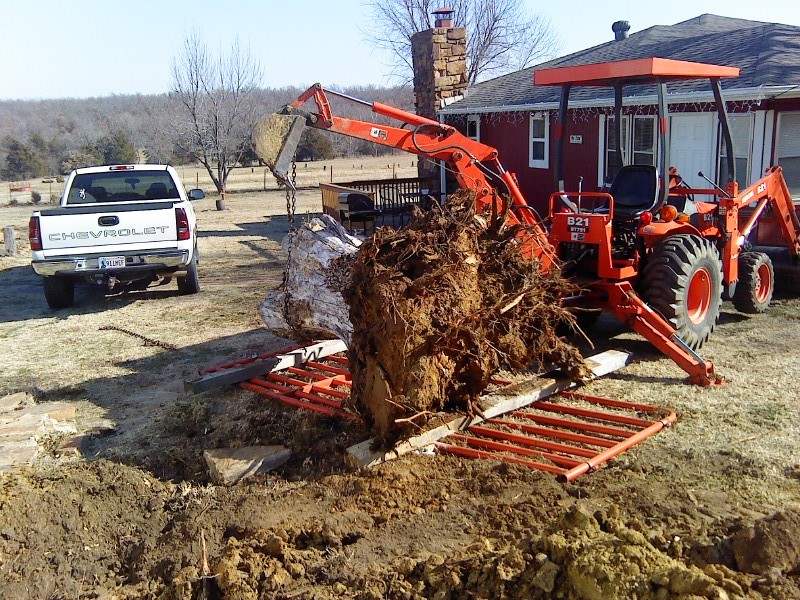

Teeny?? May be small but is for sure not teeny. It is a small tractor but is an industrial tractor and really pound for pound is amazing. By the way, the b26 is pretty much the same size as the b21. Only major differences are a 26 hp motor and a curved backhoe boom.
