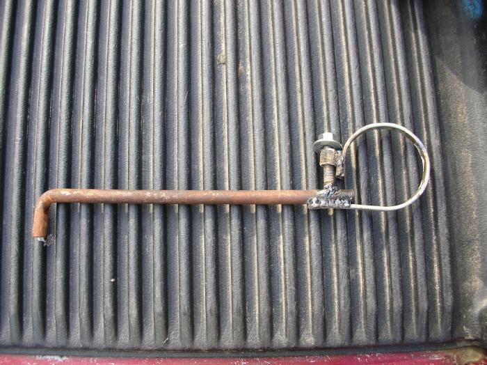

What wrench? Neither HST nor dual hydraulic filters for my tractor
were accompanied by any tooling. Not a problem for an automotive
filter wrench until I reached the HST filter. The base is machined from
aluminum and mates face to face with the steel manifold. Al + steel +
H20 == permabond.
Three automotive filter wrenches bit the dust and the filter was
still one with the machine. This (attached) was the only way to
extract the filter. Desperate tooling consisting a of chain link fence
steel strap bent to the circumference of the filter's base and welded
to a 14" foundation bolt. A scrap of 1/2" pipe and bolt of the same
caliber and it was ready for battle.
