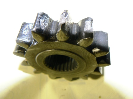

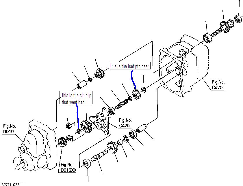

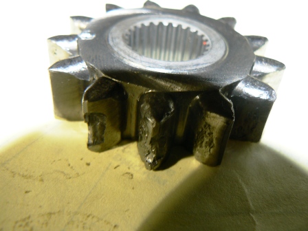

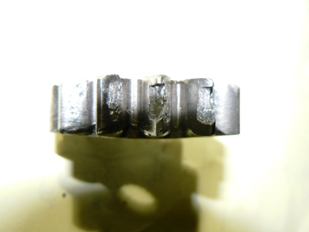

I decided to dig into my non-working PTO problem, so I removed the seat and all linkages then removed the access cover over the rear axle housing and the cover that access's the 2ND/3RD and 4TH shafts and noticed one of the gears in the middle was flopping around and sure enough its the gear that gets engaged when the PTO is engaged.
I was able to pull the gear out through the top and took some pictures of it, I will order a new one as its a little chewed up. I also attached a copy of the parts manual page that shows the location of the gear and cir clip that were bad.
I really dont want to split the tractor to replace a c clip but I need to pull the HST forward in order to access the gear shaft and install the cir clip that was destroyed. Who the heck designed the transmission this way?
Does anyone have any ideas on how to do this without the need to split the tractor?
