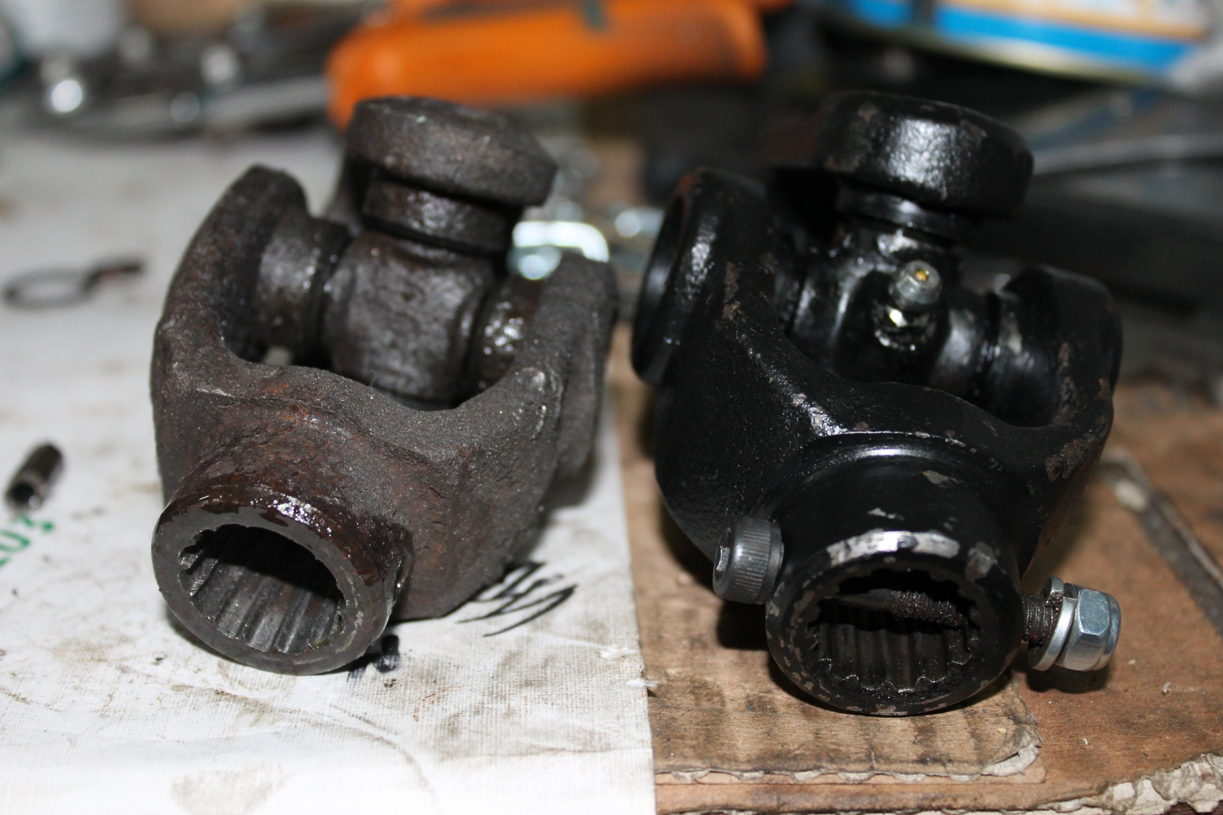

Have a older model B6000 four wheel drive and the front wheels quit driving. wondering if there is a shear pin along the driveline or do I have bigger problems. Was plowing snow and pushing quite hard. No noise, no bang, just quit pulling in the front axles.

It's not uncommon for the U joint to strip the splines. It has two U joints, one where it comes from the transmission housing and another at the front differential. The front ones is usually the one that gives up first.
I had a B7000 that stripped the U joint. It also, at another time, threw the roll pin out and destroyed the U joint cover completely. Had to make a new one.
Pic for comparison.
