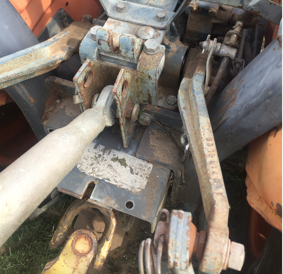

My B7100 hydraulic implement lift has stopped operating. The check rod on mine is broken. Can anyone show where this should connect to? Ive seen drawings where the control or check rod connects to a bracket on the lift arm and seems to also connect to the raise/lowers lever. I just can't see how it would connect. Could this be why the lift has stopped lifting? The check rod has two adjustable stops referred to as interlocker holders.

Here's a picture of the linkage on my B6100 which is just the lesser HP version of your tractor. Hopefully it helps. You can see the front linkage connects to the handle which is the control for the 3ph valve. All that linkage does is move the handle back to neutral position when the 3ph is either at max or lowest set height. There is a T handle right under the seat that allows control of the hydraulics to feed an aux line instead of the 3ph, make sure it is in the correct position as it can be kicked with a foot. Do you have a FEL on this tractor?
