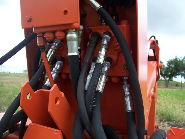

Thanks FarmerFord for the great info today as well as the info you provided some time back on the PTO pump. I am going to read this post a few more times so I get it right. I just wanted to attach a picture of 2 of the valves (stabilizer valves not pictured). Can you tell if it has an integral relief valve?
Also on my rear remotes, I have a lever under the seat that makes them work (Left-Neutral-Right) If it is not in the neutral position then the 3pt doesn't work. It is very easy to bump the lever with my feet! So my understanding is that if I don't have the integral relief valve and I go with the single in-line relief valve method, I wouldn't necessarily have to close the in-line valve, I could just return the lever under the seat to neutral? This should give me back full pressure for FEL and 3PH.

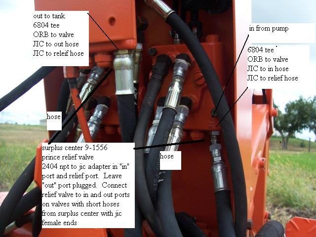

Nothing in the manual about a relief valve. Probably safe say there isn't one. Going to try to get the parts to do an adjustable in-line valve tomorrow. Hope Surplus Center will have patience with me!

Attached is my sketch of what I think you need. I am guessing a bit because I don't have a complete diagram of your system, but this might be helpful.]
Items 2404 and 6804 are from Discount Hydraulic Hose (on the net); Surplus Center does not show them in their catalog. The Prince relief valve is the only 1000 psi valve shown in the Surplus Center catalog. It is an "inline" valve, meaning it has three ports. But by leaving the "out" port blocked with the pipe plug that should come with the valve, you can turn it into a tee valve. Connect the "in" port on the relief valve to the pressure line from the pump ("in" on the right hand BH valve) and the relief port on the valve to the "out" port tee on the forward BH valve block.
I am not sure of the sizes of fittings and hoses, so you will need to measure what you have. Finally, I can't tell clearly from the picture how the valves are plumbed. The right hand valve appears to receive pressure from the pumb. I am just guessing that the forward valve (with its "back" to the picture) has its "out" port connected to the tank/reservoir through the remote valve.
Good Luck.
