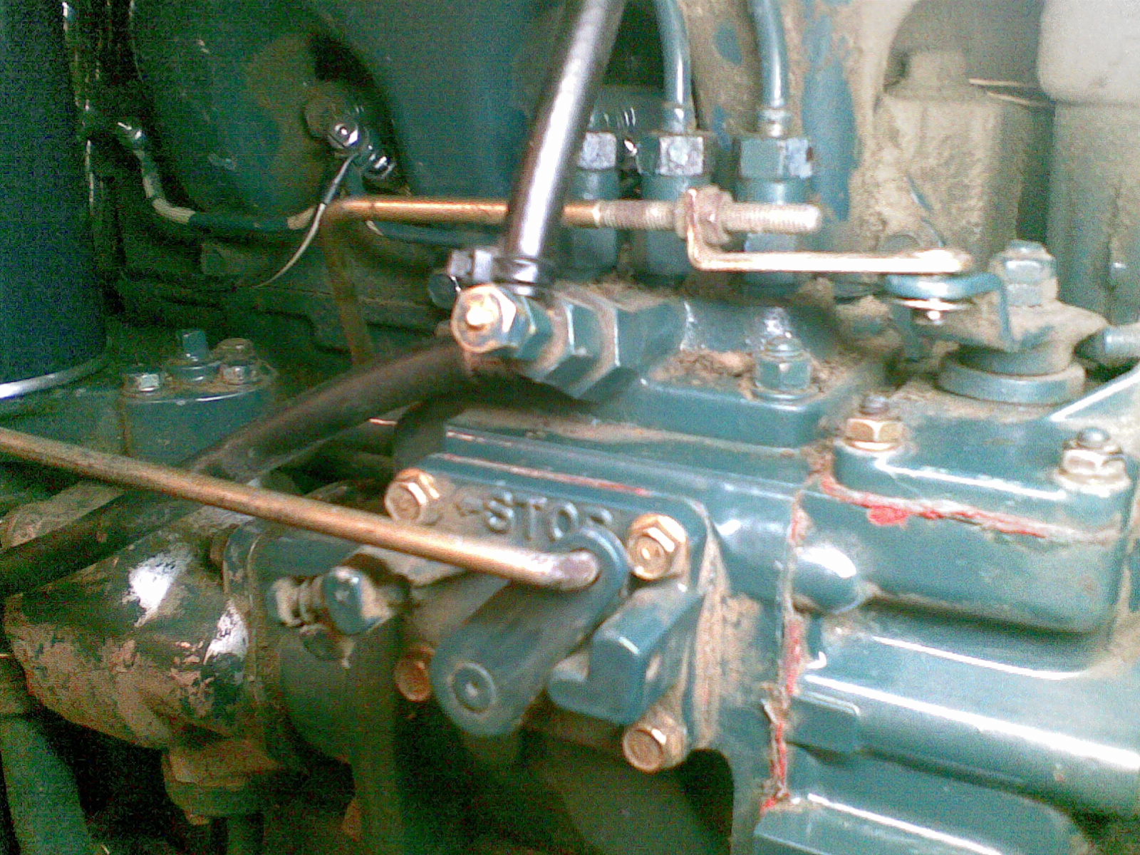

Today I had to bleed the fuel system on my Kubota L1802DT (D1102) and noticed a problem with the bleed valve.
I think it is missing the knob off the end?
Does it look broken to anybody else?
Does anybody know where I might get a new one, online if possible. The Kubota folk here are real nasty about grey market units.

Hi mate no that is not broken that is the way they are made it should look like a ball bearing in the end of it if you have probs with the fuel system some good blokes to talk to were Peacock and Smith don't know if they still exist though they where in melb when i worked there in the 80-90s
