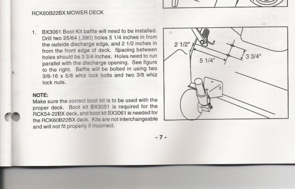

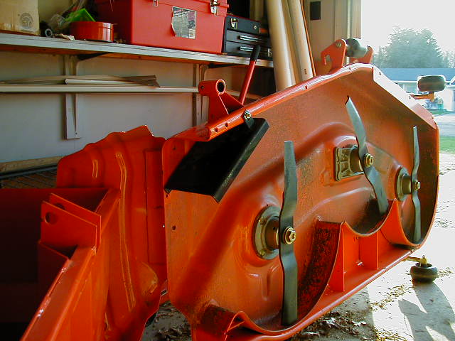

I have misplaced the instruction/owners manual for the GCK60BX grass catcher bagger system. I need the information on the location of where the baffle gets mounted on the inside of the 60" mower deck. If anyone can supply that information I would greatly appreciate it. A picture of what it looks like mounted would also be nice. thanks in advance..... Junk..

Here are two photo's I have from when I re-installed mine (dealer installed incorrectly). I will also post the manual piece as soon as I scan it.

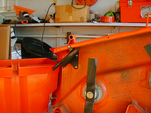

Heres another.

and here's the manual paragraph

Hope that gives you what you need as they are the only photos I have of it. The deck is on the tractor and won't be off until after the leaves are all gone so I won't have an opportunity for further photo's for quite a while.

Thanks....... that is what I needed. The only other thing that might have been better was if Kubota had supplied a template that you could lay on the deck, center punch and drill the holes. If GM could offer templates to mount mirrors and antennas in the 1950's till they became standard equipment on the cars, one has to wonder why Kubota doesn't print one on a page of the manual for the user. If anyone wants to use the excuse that they are meant to be installed by the dealer, the templates I speak of were for the car dealerships.
