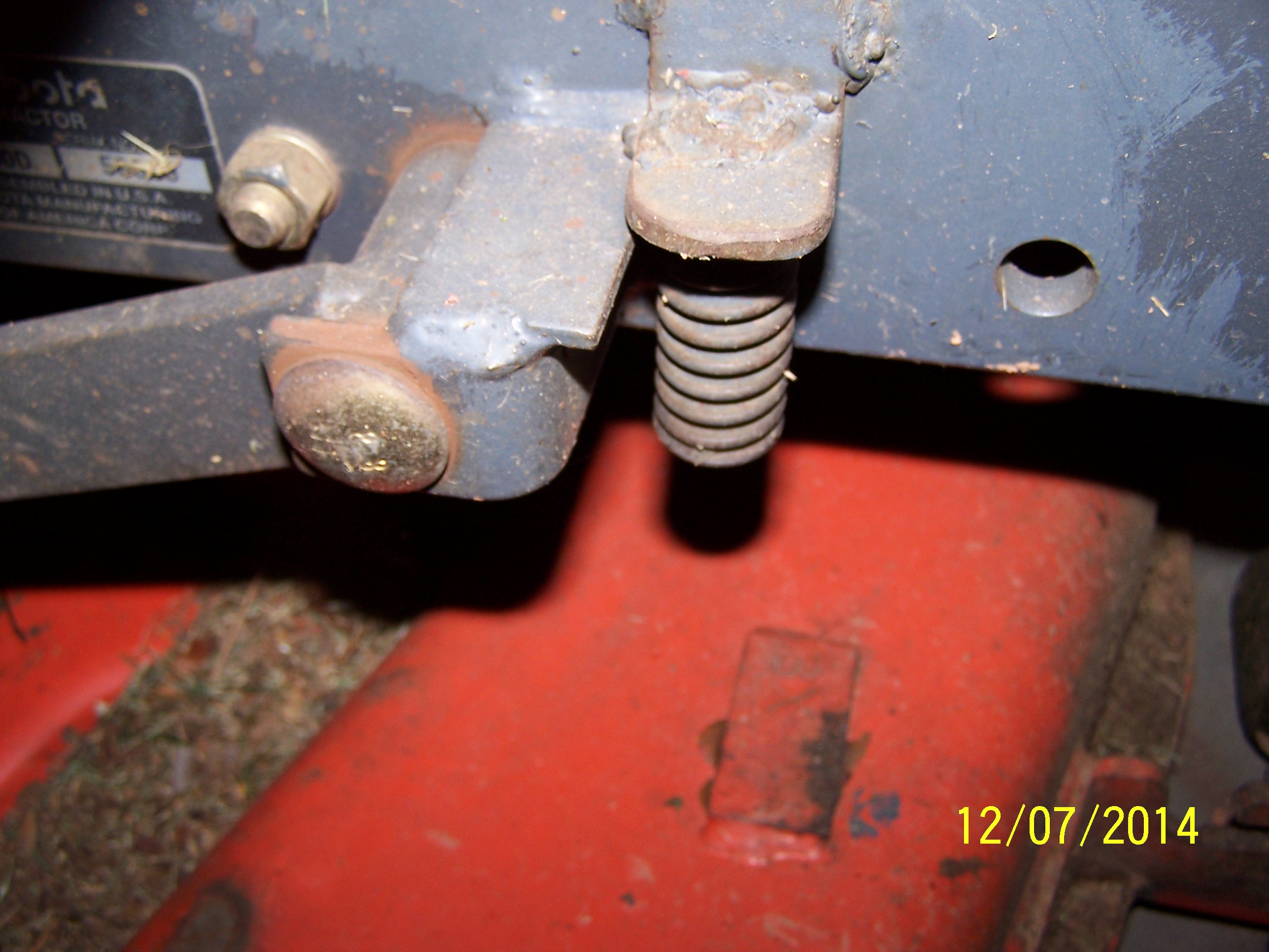

When I test drove my BX back in 2000 I went over a curb to check clearance and the MMM hit the frame with a loud BANG.Kubotas solution was to weld a small thick piece of steel to the MMM deck. My solution was to weld a die spring for the MMM to hit = no more BANG! Hope this idea helps someone!

Clever!
   / Kubota BX MMM (BANG) #3
Nice!
When I have my mmm all the way up it bangs on the frame going over bumps so I have to drop it slightly. Something like this should solve my problems.
Thanks
   / Kubota BX MMM (BANG) #4
Cool idea!
Zick, it sounds like your deck is out of adjustment. It should not bounce when you hit a bump.
   / Kubota BX MMM (BANG) #5
So when you put the mmm in the top locked position, should it be pulled tight up to the frame?
I'm sure you are right, mine is probably out of adjustment.
   / Kubota BX MMM (BANG) #6
Thanks for the Idea. My BX2200 is an 2001. Of course the banging of the deck when fully raised only comes up occasionally the banging is rather bothersome. :confused: Might try to weld a spring system up this winter if time permits. At least have the parts ready when I start up the mower deck next spring. :)
