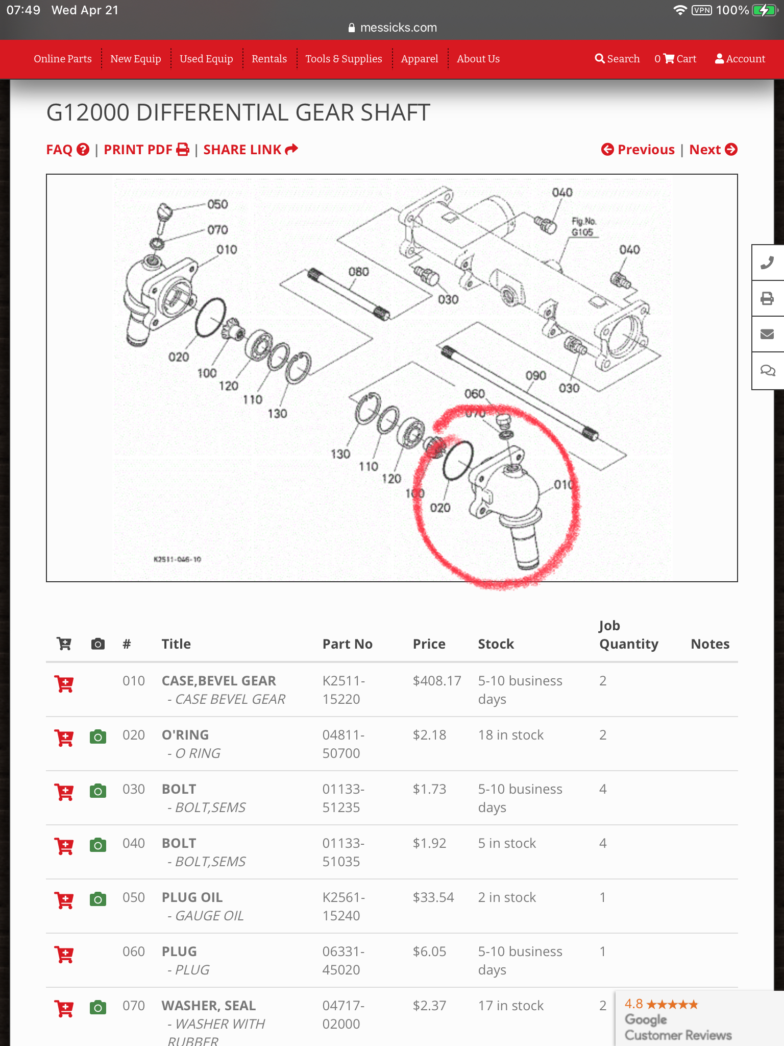

Around 20 years ago I bought a Kubota BX1500 with an end loader. I use it mostly for driveway maintenance. It's served me well but yesterday I noticed a puddle of what I think is 90w gear oil around the right wheel. Have any of you other BX1500 owners ever had yours spring a leak there? If so, what did it turn out to be, a gasket or the seal? Also, do any of you know where I can access an exploded view of the front axle assembly with part numbers?
Thanks in advance for your help.

I owned a BX2350 for 10 years. I don’t know what to call it but the front axle sort of stepped down and out to the wheel. This pivoted also and mine leaked in that area, which seemed worse when I used the loader for heavy work. It was pretty minor though and I never messed with it.
   / Kubota BX1500 #7
I believe this is the seal that Dodge Man is referring to. Clean it up and confirm that's where the gear oil is coming from.
Messicks also has parts lists, and this one is for a BX1500d

I really appreciate you sending this diagram. The area you have circled is definitely where mine is leaking. I'll pull it apart and take a look at it.
Thank you
