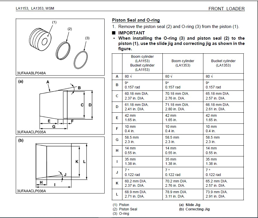

If you are doing this regularly, why not make the special stretching and compressing tools Kubota's details in their loader shop manuals?
I have attached the jig details for a different loader to explain what I am talking about.
I think the idea of using the jig is to avoid any twisting of the components.
Dave M7040
   / Kubota BX2200 LA211 Bucket Actuator Seal Rebuild Photos #6
Dave M7040
I 3D printed a few for my Kubota B21. They worked fine. The slider (a) is necessary IMHO, the "corrector" works if you can get a good smooth print. Otherwise compress the seal with a properly sized hose clamp, using a cutout from a soda or beer can
Also made a "pusher" a device with "expanding fingers" that push the seal down over the slider. A lot safer than other ways I've tried.
I posted the FreeCAD files somewhere on TBN but could post them again for those that have a compatible CAD program or just the print files (STL) for someone to print locally. For the latter I would need the dimensions.
