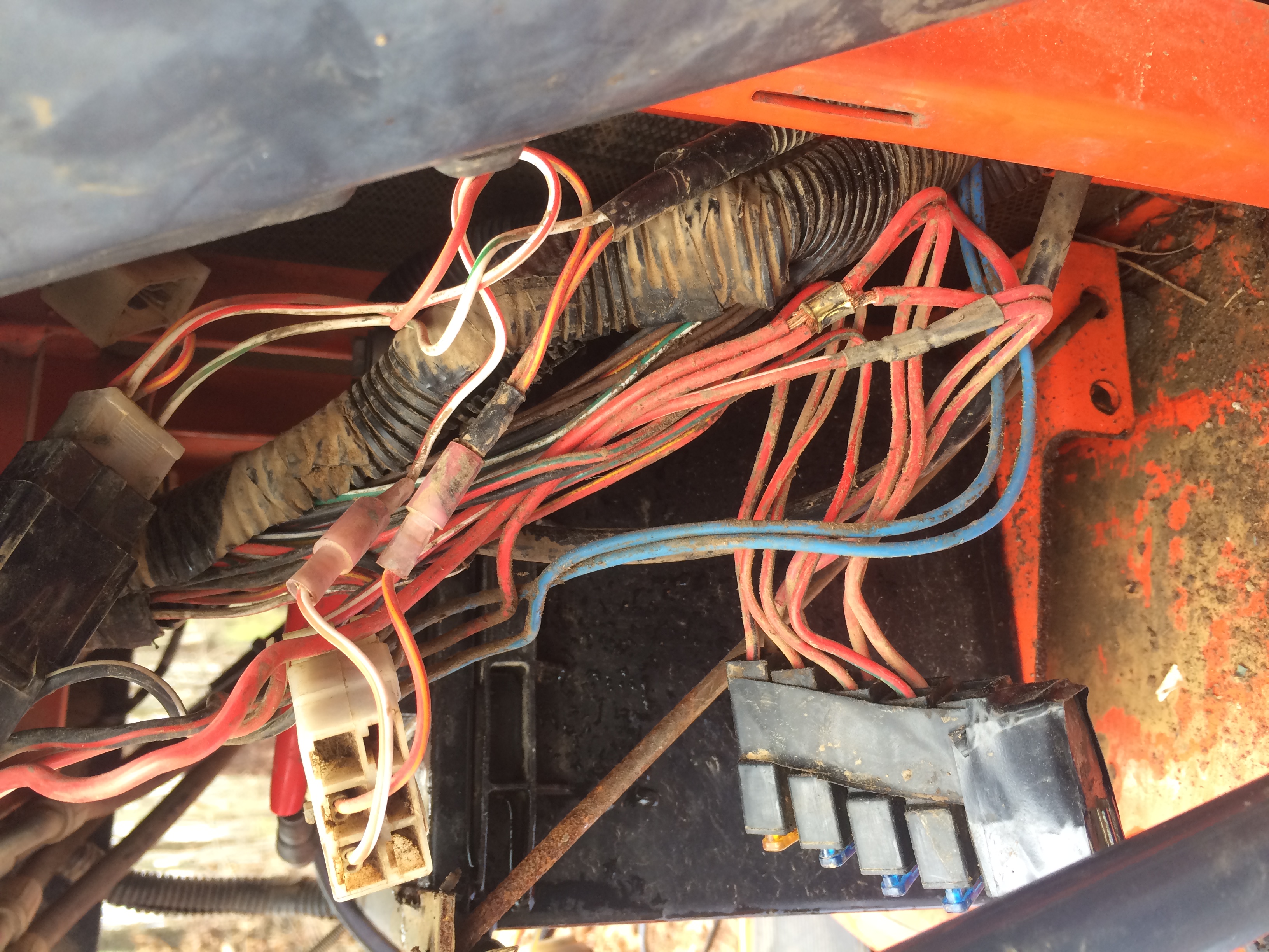

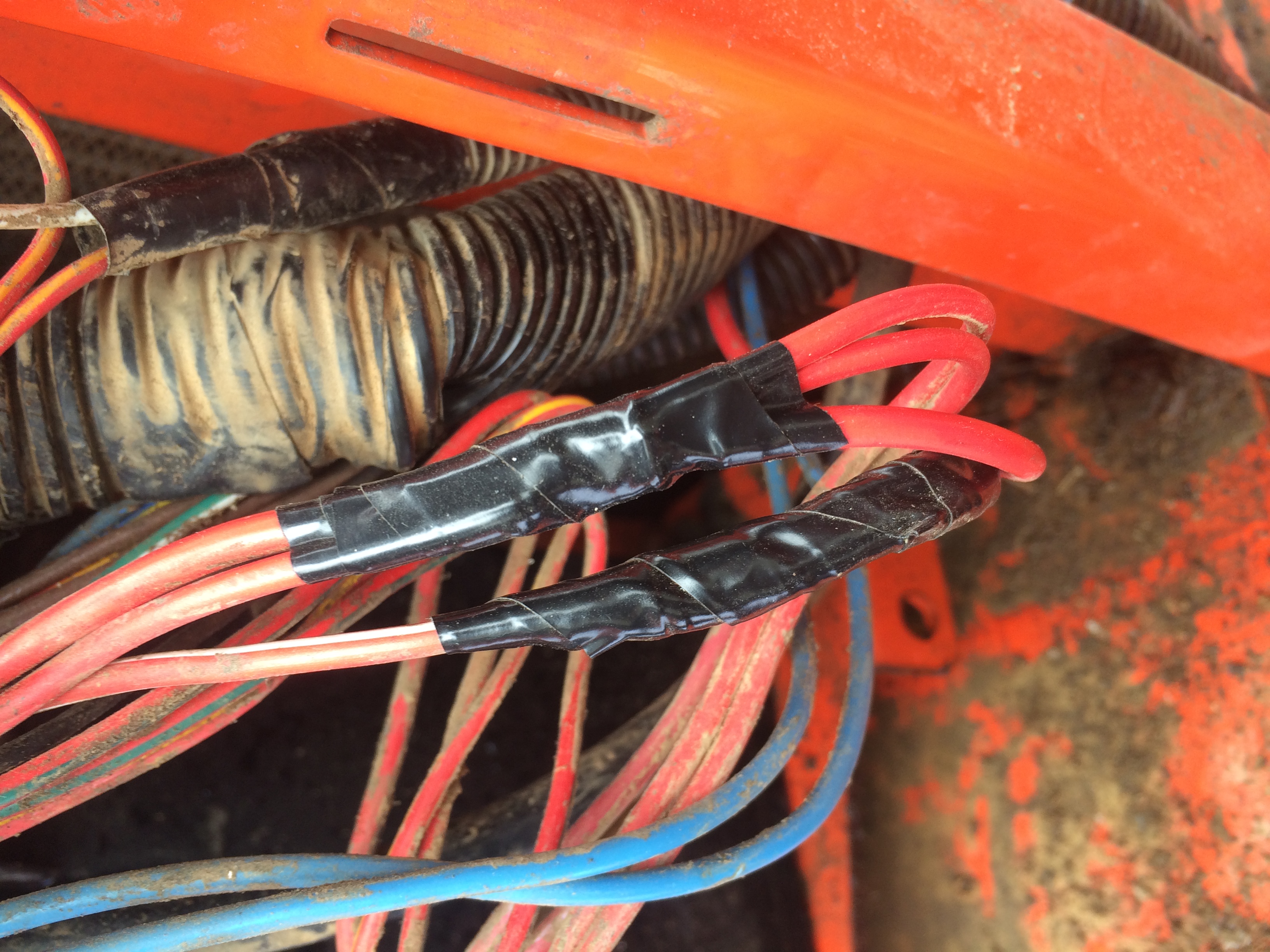

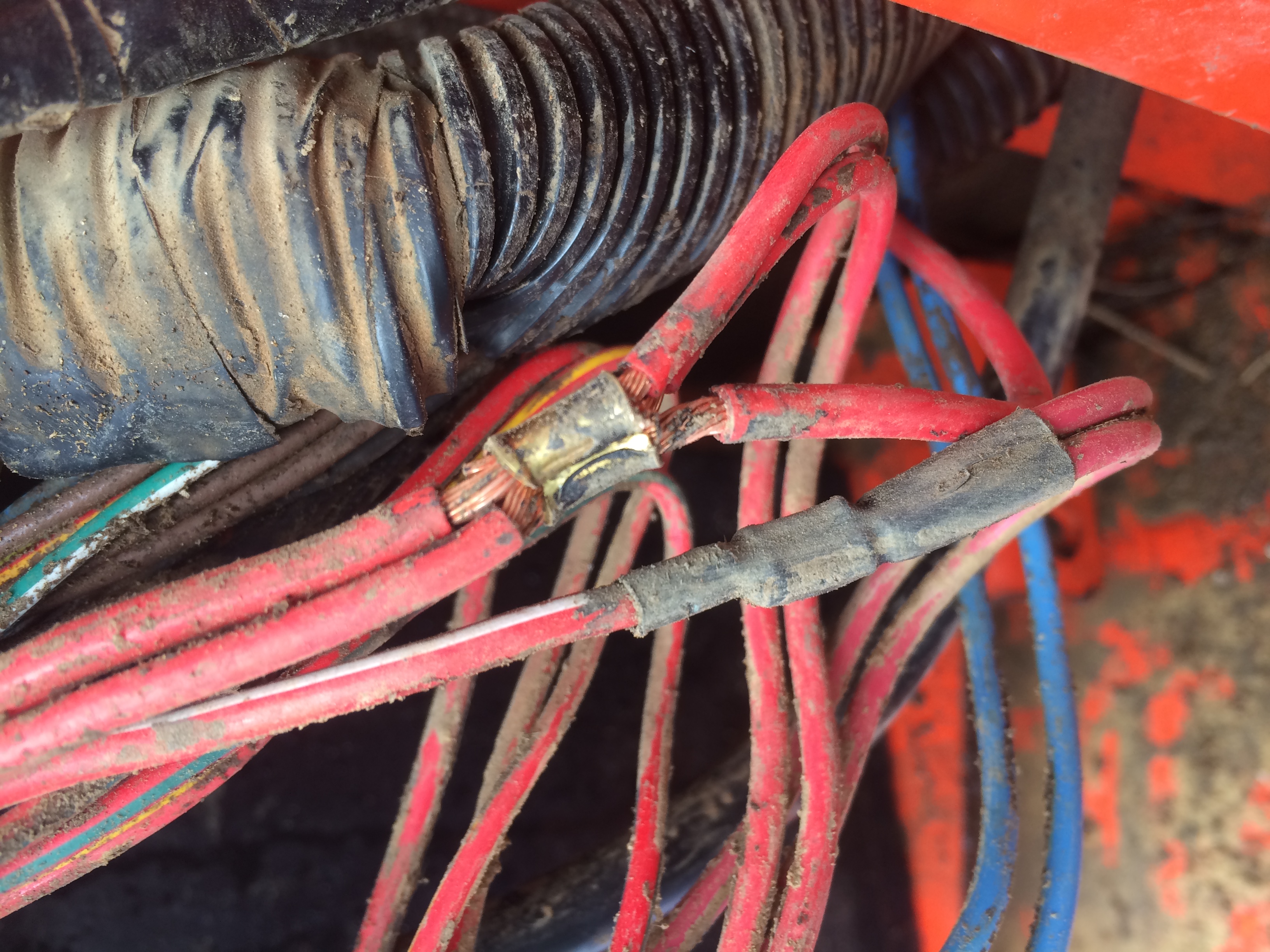

I finally figured it out. After testing most of the electrical components on the tractor, I decided to take a different approach. I started at the battery and followed the red wire. I cut all of the tape and pulled off the flexible conduit as I went.
I found a heat shrink that was failing and letting voltage through from an adjacent uninsulated splice that was taped together with the heat shrinked splice. Once I pulled these 2 splices apart, the problem stopped

What a mess. I guess K is not worried about weatherproofing their wire connections.
   / Kubota BX23 won't turn off...new twist #5
It made it 13 years in what looks like very sandy and probably somewhat salty conditions(going by the rust in the pictures), while stored outside. I wouldn't call that terrible. Nothing lasts forever without some maintenance.

You did good !!!! Those kinds of things are hard to find.

The practice of using shrink wrap on two adjacent wires still allows moisture to enter the connection in the space between them. Using the shrink tubing with the added sealer would help this issue.
