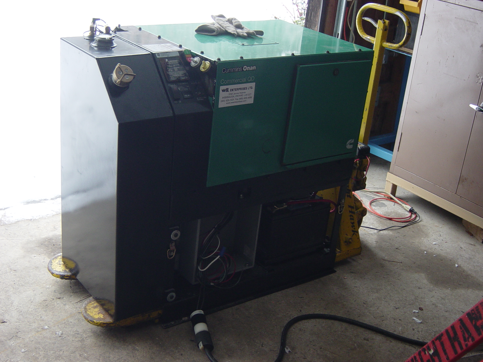

I have this engine in a bunch of things and never had a problem starting it again if it ran out of fuel.
I got an Onan Generator with this engine and it had probably been sitting for years, without any fuel connections, yet started right up.

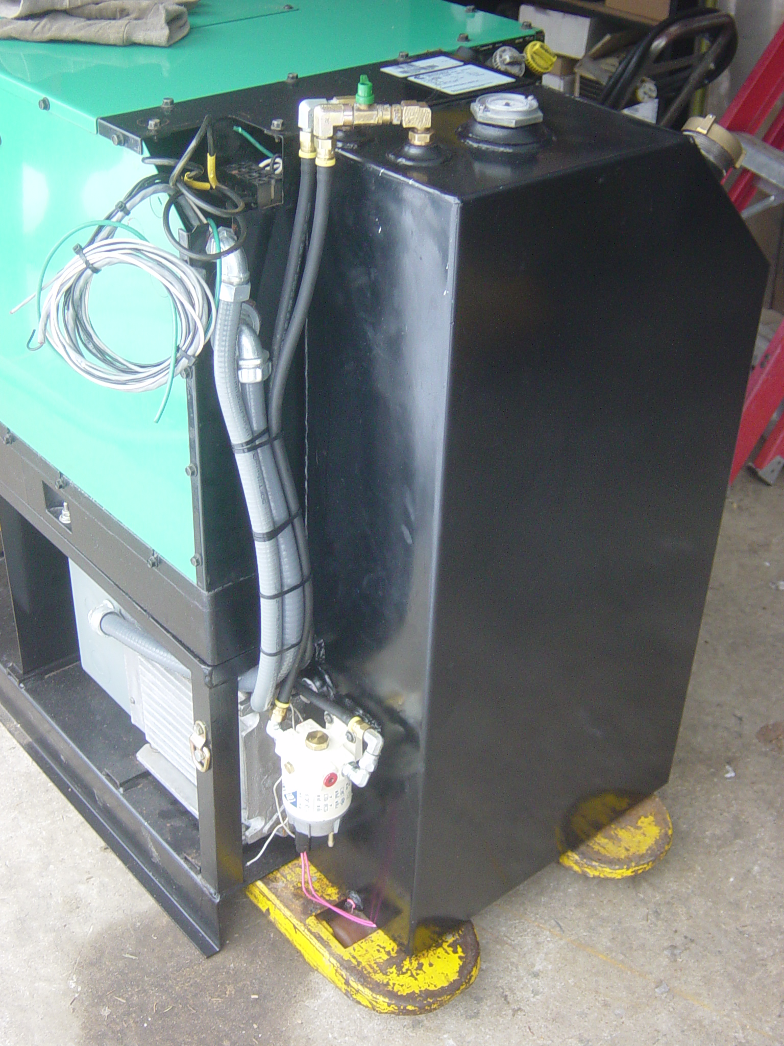

Now my project is nearing completion, I got a fuel tank, lines and filter, and I couldn't get the thing to start.
No smoke from exhaust, but had fuel at the injector pump inlet. It has an electric lift pump and prime switch position, which is handy for priming.
Fuel was returning to tank on cranking.
Cracking the line to the injector pump seemed to help, but it was a struggle and FINALLY, bit by bit, she came to life.
Any ideas?
Thanks.

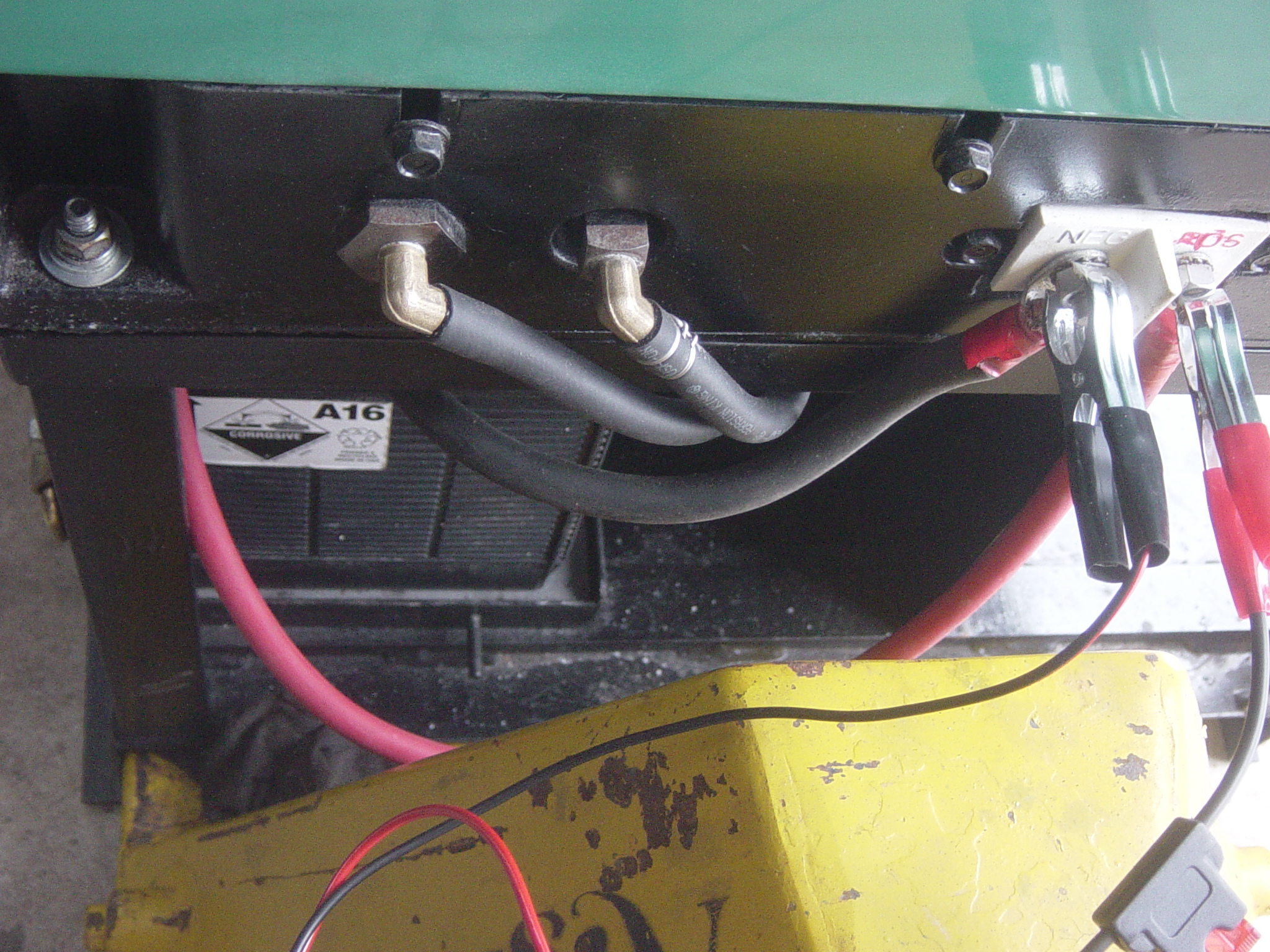

Went out after a day and was almost certain the thing would fire right up. Wrong! Hint of white smoke, but no start. Battery was wearing down, so I put a charger on it to get the cranking speed up and finally it started.
Suspicious that I just installed my new fuel system, (because it always started rightup) but at the same time it's also gotten colder and I know my Steiner with the same egnine will not start without block heater or glow plugs.
POSSIBLY, it's a coincidence and my glow plugs or circuit are non functional.
I have looked but can't find out what a Kubota glow plug for this engine uses for current or the (cold) resistance.

WELL, it seems I have a leak on the suction side ball valve I installed.
Handy to have a DC clamp meter. Showed about 30 amps for glow plugs, same as my 7.5 Onan/Kubota Conventional set. So, I am relieved.
Not sure my decision to make a pickup tube from the top of the tank was too smart. Not sure if a 1/4" ball valve is designed for suction application.
   / Kubota D722 Engine. Self Priming or Not?
This is becoming annoying. Loss of prime persists. Checked suction pipe solder joint and replaced valve. Even closed valve and after a day, generator pump has lost prime.
Is it possible for a hose/barb connection to not leak fuel under pressure but let in air if there is a vaccuum on it when not running? All the OEM hoses have crimped on hose clamps and I notice I can turn the hose on the barbs.
