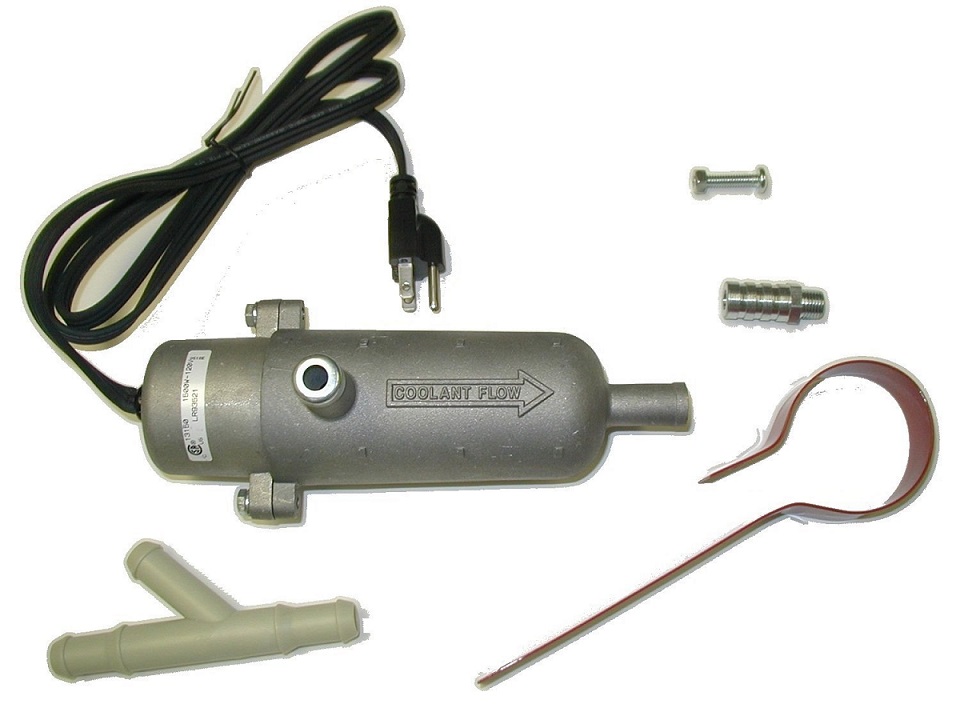

Over the years I have installed the KATS lower radiator house recirculating unit a number of times with much success. It's a "Y" type thing in that the main part connects to the lower hose and the other part intended for a heater hose or block connection. This setup causes the coolant to circulate very well and kept my engines warmer than with a block heater. If you have a block drain on this tractor I'll bet this would work very well.

What you describe I have never heard of and is brilliant! However, I'm concerned that the protruding two or three inches (am I right or is there more?) of plumbing, if hit with much of a blow, would dislodge the entire apparatus from the frost-plug hole. For me this is a real issue. I use the tractor mostly for logging and, despite a skid plate and other protective armor that I have installed, I'm afraid that eventually a branch or something will hit the apparatus. I'd really appreciate any additional thoughts.

Sixdogs, I thank you! Although I have never seen such a radiator hose heater, I can recognize immediately how it could overcome the poor performance I have experienced with standard lower radiator hose heaters. I'll look into it. Thanks again!

It's been number of years and they may have evolved these a bit but here a picture of one from the net. You need an in and an out for the heat pump to circulate and it works excellent. I recall one model that seemed to go from the large rad hose as well but any of them work great. On my plow truck or car I could get in and the heater instantly tossed hot air. On a tractor it worked well enough to warm the transmission oil a little bit as well and I lived in northern New England at the time. This is just what everyone used and I left it on overnight. Everyone did.
I got this off of Amazon that had one for sale. Those lower hose heaters have never worked for me or anyone I know.
Amazon.com: Kat's 13150 1500 Watt Aluminum Circulating Tank Heater: Automotive

rbargeron, I guess my reply of a few days ago didn't get through to you. Anyway, thanks! I didn't understand. What you describe I have never heard of and is brilliant! However, I'm concerned that the protruding two or three inches (am I right or is there more?) of plumbing, if hit with much of a blow, would dislodge the entire apparatus from the frost-plug hole in the engine. For me this is a real issue. I use the tractor mostly for logging and, despite a skid plate and other protective armor that I have installed, I'm afraid that eventually a branch or something will hit the apparatus. I'd really appreciate any additional thoughts. Also, are you familiar with the type heater that sixdogs suggested?

I did see your post - how hard or easy it is to rip it out depends on how well its put in, and what can happen to it in service.
When installing mine, I cleaned the tapered hole, applied permanent Loctite, and used a deep socket and long extension so I could align it well for driving it into the tapered hole with a lead hammer - it's really in there. It sticks out only a couple inches - and is somewhat shielded by the starter which sticks out more. The cord and plug are exposed - they're held in place by heavy zip ties - no snagging issues yet. My L3250 has a hose-connected heater but I haven't really compared it's function with the freeze-plug type.
Only a few owners have actually stuck a tree limb through their radiator from below, but anybody who has is likely to prefer a very brush-proof setup. The heater extension has worked for me - your results may vary, as they say. Take care, Dick B
