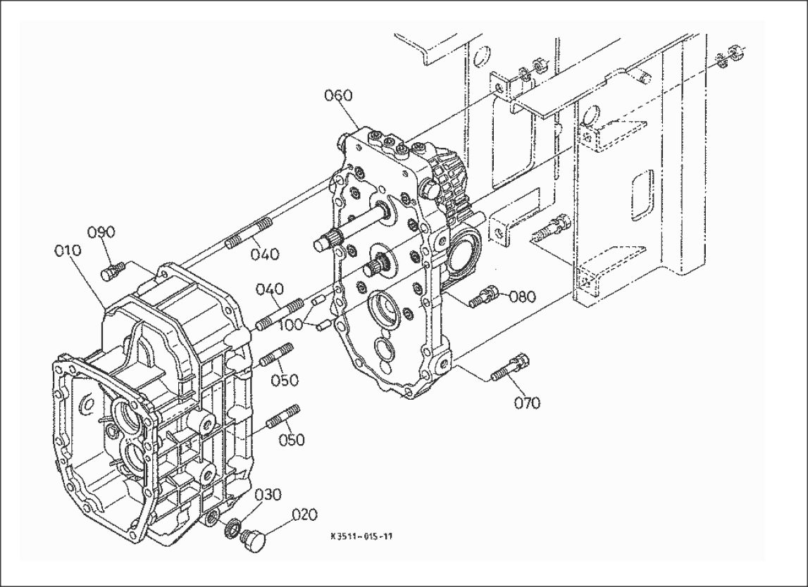

Housing, item 010 below had a hairline crack by one of the large frame mounting bolt threaded holes:

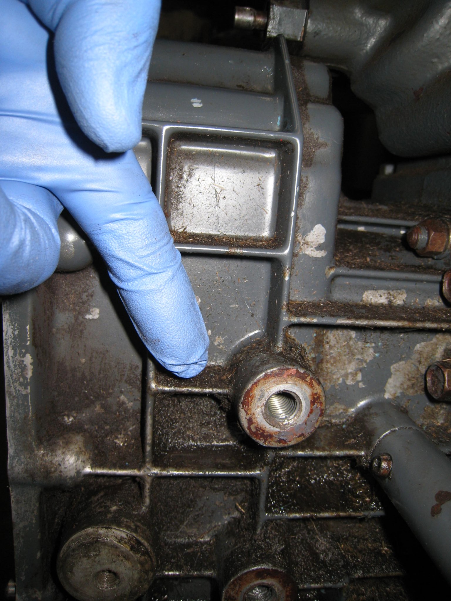

A long hairline crack is visible about 3/4" right side of my finger:

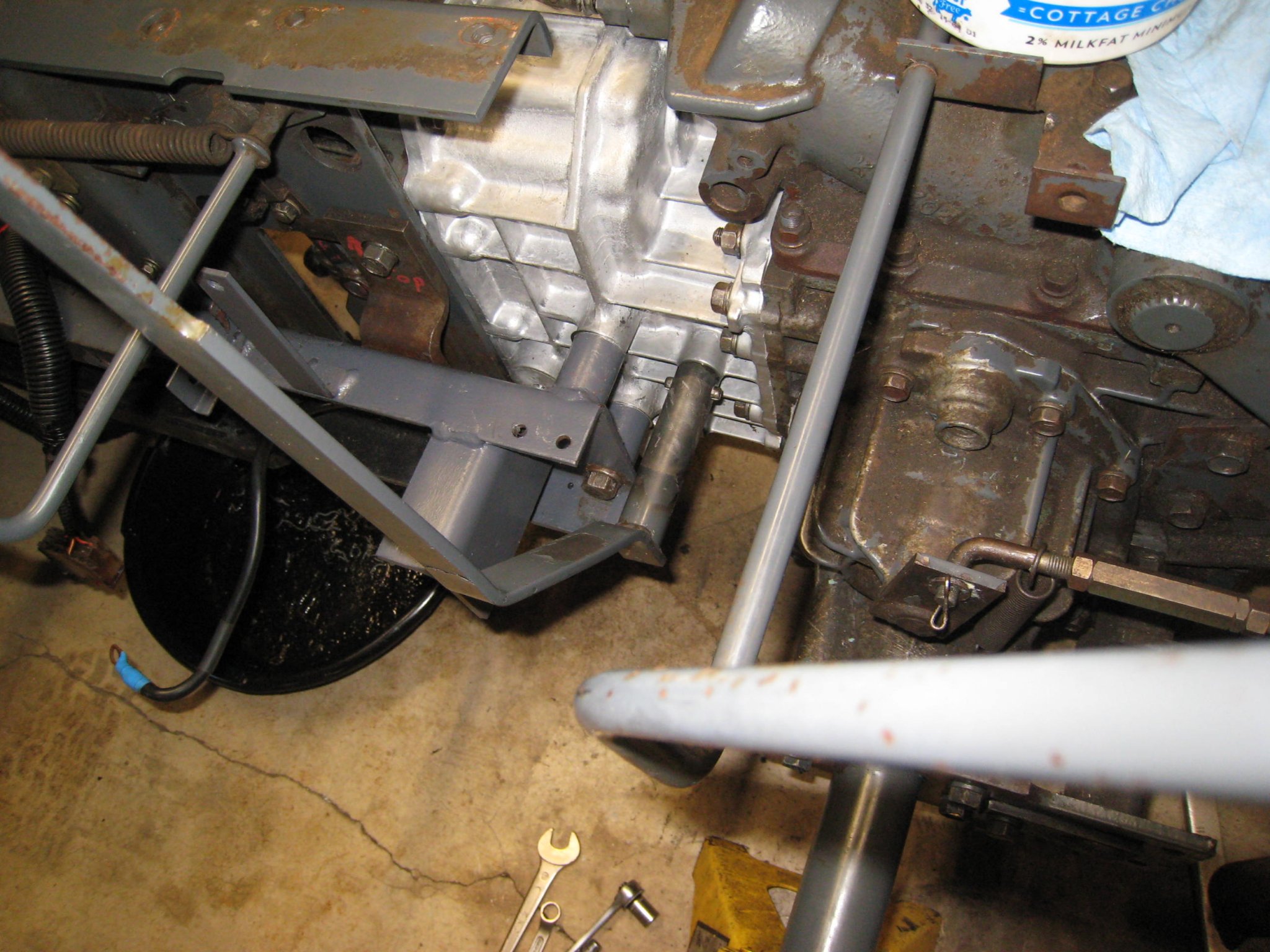

New housing in place - the new shims are visible in-between the frame & housing if you zoome in close:

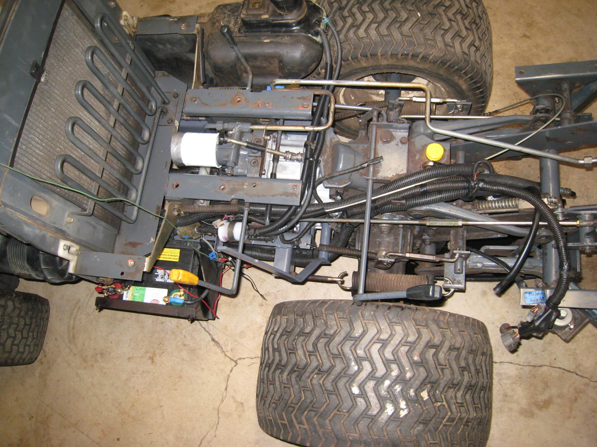

It's nearly impossible to see the area in question when the frame, hydraulic hoses etc. are all assembled back in place and eventually covered with a fender on top:
