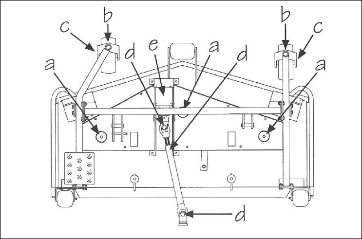

I just replaced worn lift link rubber cushions in my RC72R-F30 mower in order to limit the amount of mower deck forward tilting when mowing uneven yard.
Just trying to keep the 90 degree bevel gearbox input shaft and the mower PTO output shafts aligned as much as possible.
If the deck tilts forward too much, it will cause noticeable vibration.
This is probably not as big a deal on newer side discharge decks which have a different style gearbox with "integrated" center pulley and no gearbox offset.
Gearbox Offset:
