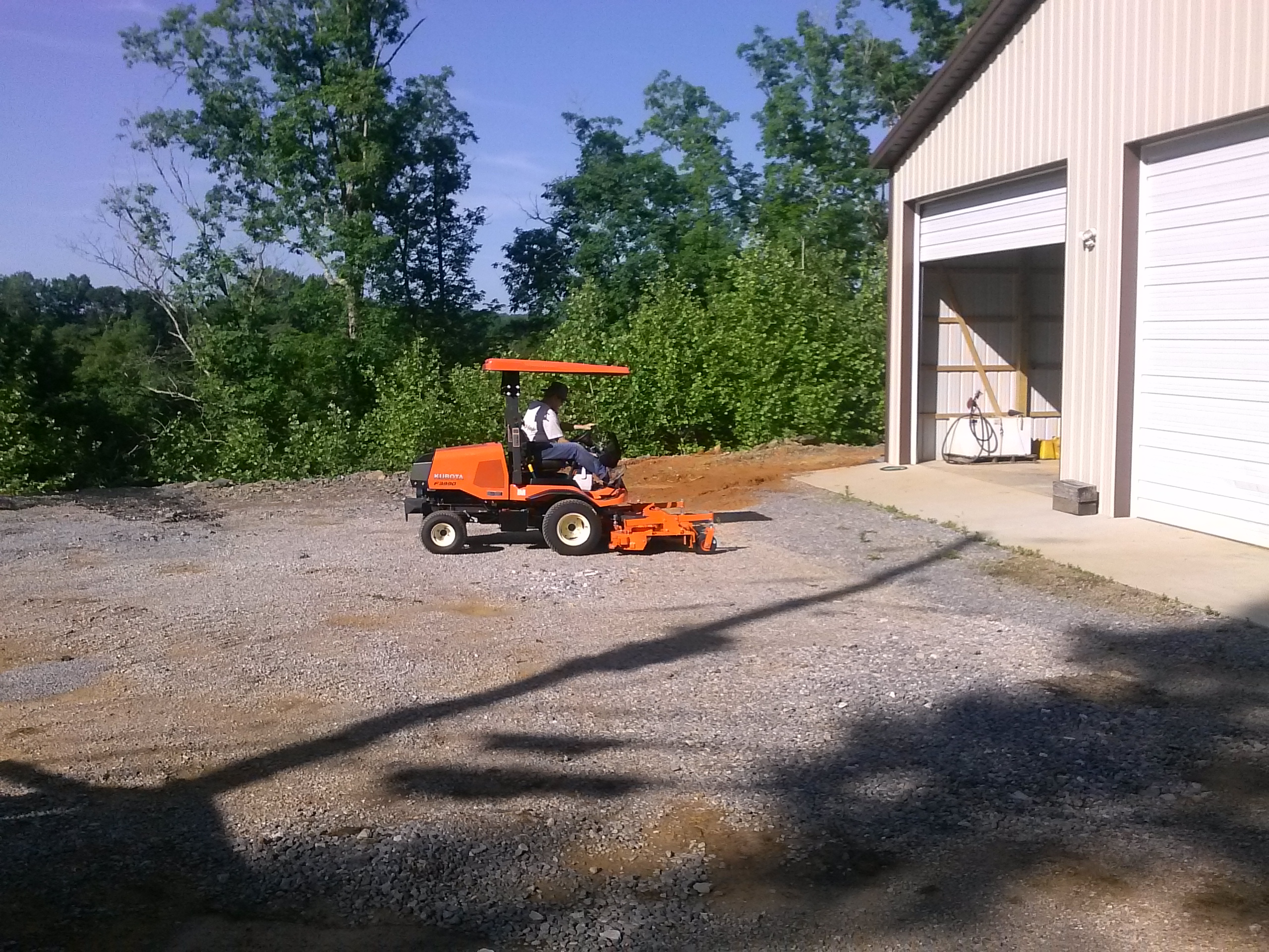

Well the 3990 came in 2 days ago, but finally got to use it today. Sure gald I got the 39 over the 2690. The 39HP climbed my hills and had to ease up on the peddle because its steep. If I had the 26 I would be ticked off right now, but the 39 did great. The grass and weeds were 2.5 feet and it went right through it, but did need to keep it a bit slower because it was so high.

When I was on the JD tractor, I went real slow and many times the angle got way to much so I went another direction. This thing climbs like a goat and never did I ever even a hint it was going to flip/tilt. It slid a tad every now and then, but no worries
Sometimes one has to push the diff lock pedal to get a wee bit more grip, even on the mountain climber. There is also the choice between sort of and a bit more all wheel drive/4wd/3wd which I rarely engage to the most traction mode
On the way to the land cruising flat out in high, all good. On the way after 6 hours of cutting, it had a higher pitch squeal, and when it started to climb a hill it got louder. At home checked fluids and all good. Maybe its just does this, but going to call Barlow tomorrow
I some times move up the road and use the high mode but always move it back when mowing,always because It will go faster in low mode than I can stay on it while mowing and it reduces the whine in low and also guarantees full climbing ability. My money is you left it in high mode thus getting the higher amount of whine.
Sounds like your trying out your F and learning as you go. It's a great mowing machine with 4 tires and metal blades made for mowing grass and weeds and maybe a few small trees. Not a track machine but close.
