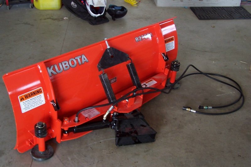

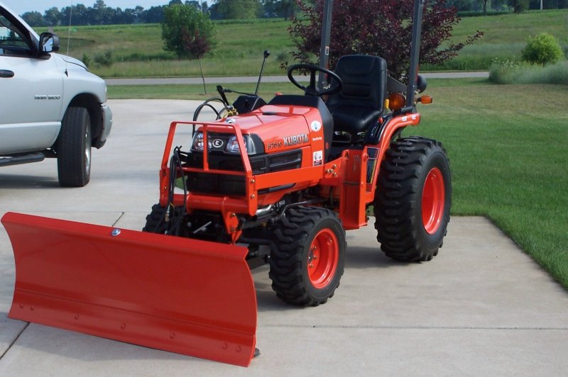

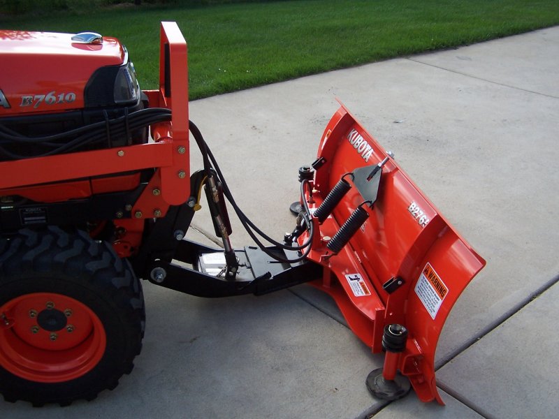

Do any of you plow snow with a front blade on a B series? In searching for a friend, I could find zip on Kubota's website showing how a "factory" front blade is mounted on a B.
I have showed him my BX setup, with the QC system Kubota uses, but would deeply appreciate photos of Kubota optional front blade is set up on say a 2000 or newer B tractor. Thanks so much.

Here are a couple pics Killer B posted. Its the previous design B, not the new 20 series...... but the plow / QH look the same on the 20 series.
   / Kubota Front Blade On A B Series Photos #7
That looks identical to the blower mount on the B3030, the subframe sockets in to the back of the blower, rotate the lever and pin it.
   / Kubota Front Blade On A B Series Photos #8
Wish I had kept pics of my old B3030 with the Kubota blade :rolleyes:
One nice difference between at least the Bxx30 series and a BX is you do NOT have to remove the front brush gaurd on the B were you do on the BX to mount the Kubota quick hitch. The quick hitch is used for the Kubota broom, blower and blade. The broom/blower also need the mid pto kit for the quick hitch to provide power from the mid pto to the front. The blade obviously does not require that ;).
