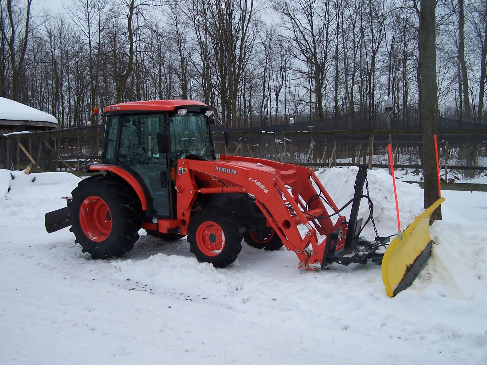

100_0818.jpgI have a 8ft .converted truck plow,8ft.,I wouldn't want any smaller on my L4240.Also use a seven ft.rear blade.I think Curtis makes FEL mounted plows.
