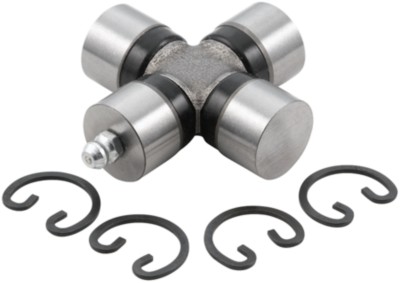

It would be nice to have a grease zerk, but though Napa UJ410 has been recommended as an alternative, it does not fit my model (correct diameter but too long to fit within the yoke).
3264889
AIL4fc_KerFZnNFfb-kUHUdSN8XuuoDKw1gAfEzu36MLbxgFKKRKWjTnOuDATdMfGxvMA86wChSYyYE0JOIezvcqSRJzyydP01FHxp558XOa_nqwy60SN0QeInCyRmIczIo7-l2tEqDFLt2rQFqn8gIPiVbqXQ=w748-h1112-s-no
AIL4fc_gp1ynejpZqQ-S5gbnK_1vTeRqgXuawnozgv4eSi5HOVir69G3HxVMYsnAG3bWY2BBELF6c35jonglr5J3fvhV0zE-YPDTmsfe1haUhYckjXytOMYbFI2qGaKn77PgxS3lewLFG-VqYDE2yNjgNIPrRw=w1192-h1112-s-no
I failed to find anything else locally, and my neighborhood Kubota dealer does not stock the part, so I ordered 66091-61830 from Messick's and followed this approach for easy assembly.
