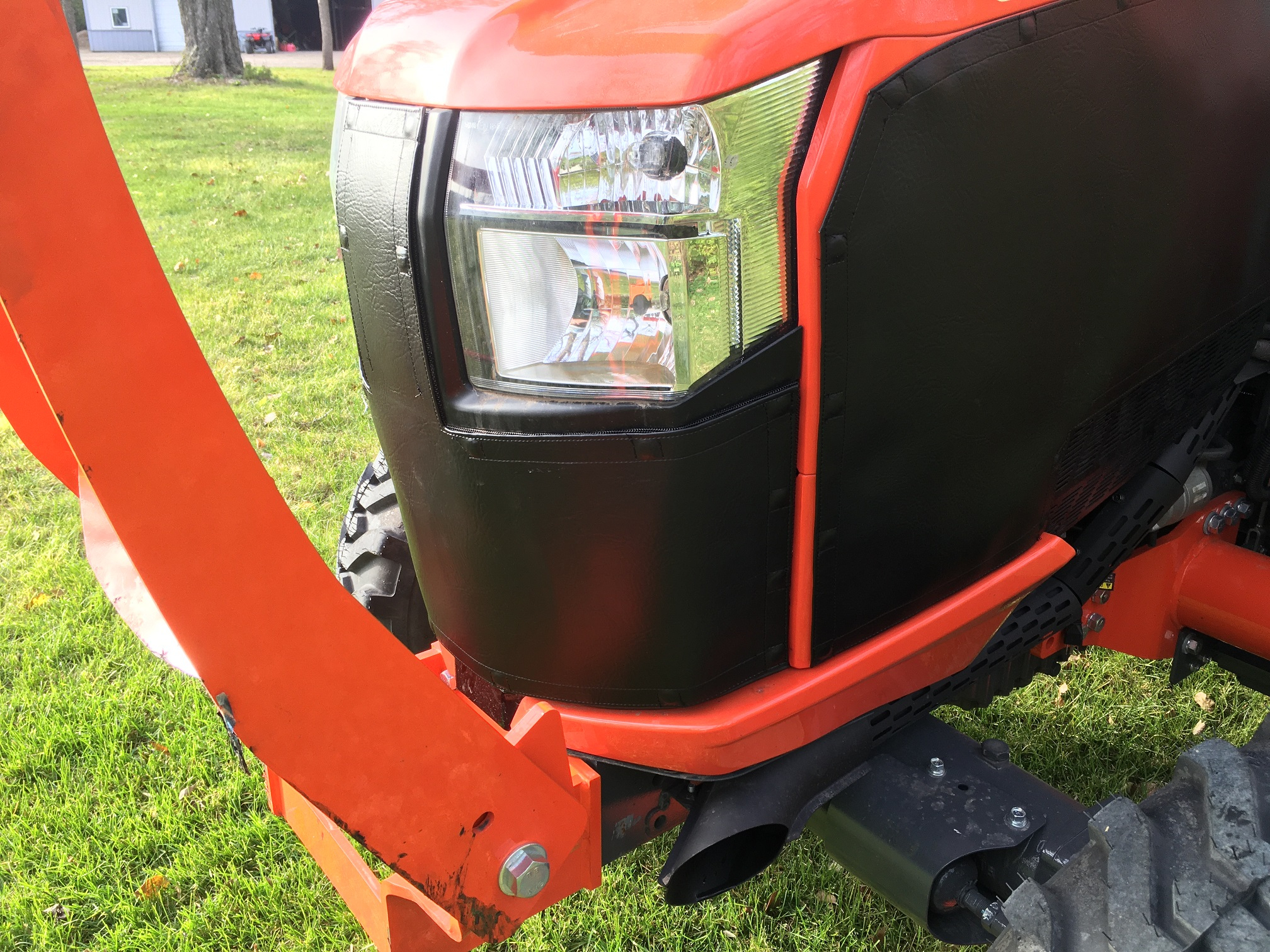

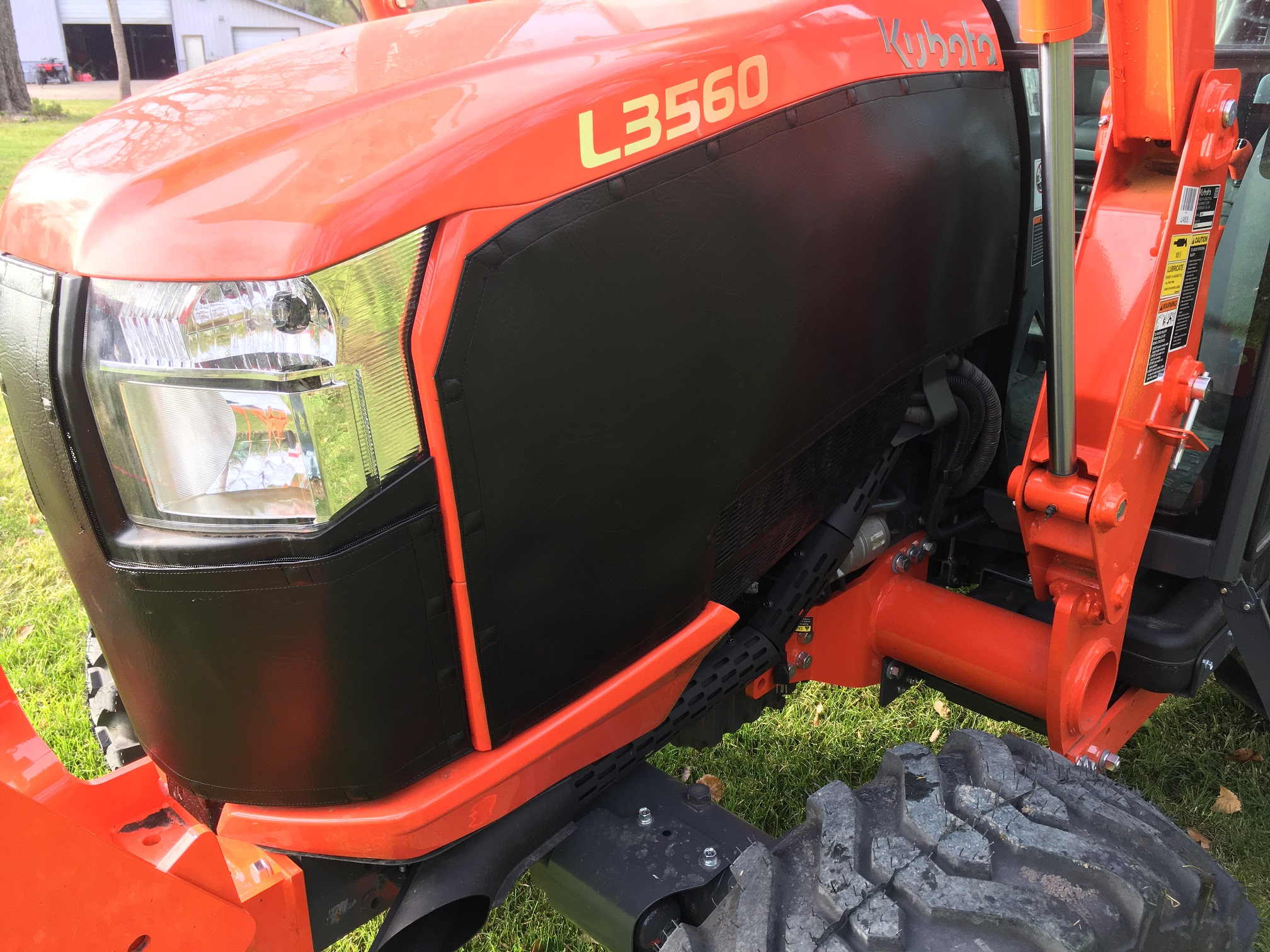

A few Grand L6060 tractor owners have asked me if my L3560 winterfront kit would fit their larger '60 series tractor. I wasn't sure....even though I was led to believe that they would. Now we have proof with pictures of the covers on a Grand L6060.
Here's thumbnail pics of the winterfront kit on the 3560LE
L3560 LE Winter Front Covers Front Piece.jpg L3560 LE Winter Front Covers Left Side.jpg

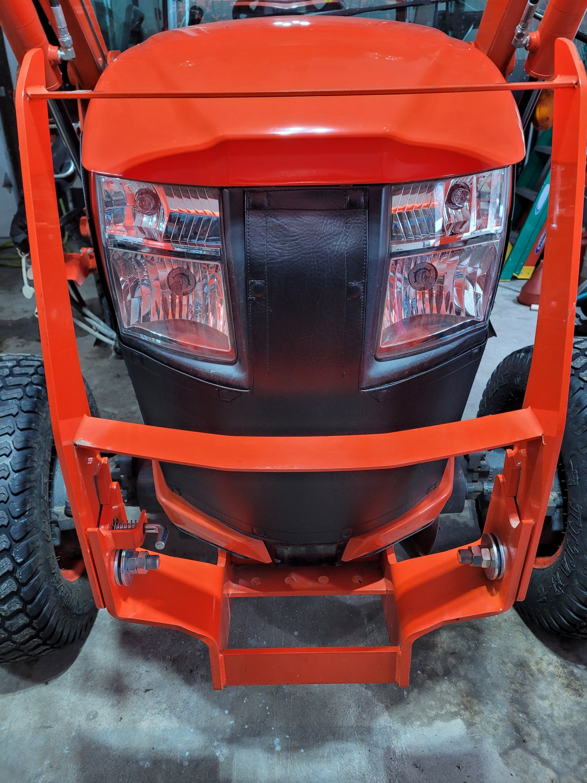

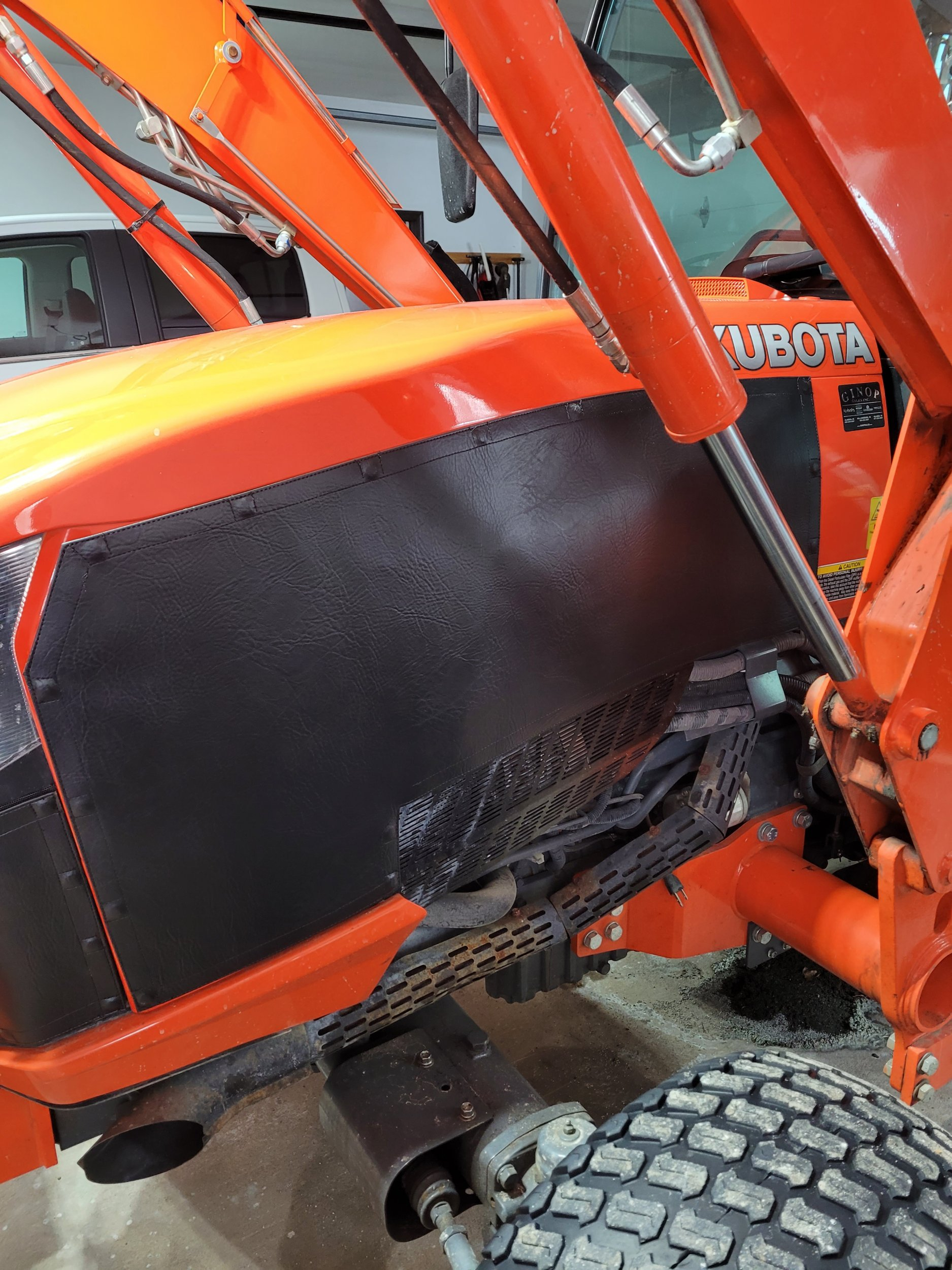

And the covers on a Grand L6060:
The difference between the models is the Grand L '60 hood has been lengthened a little bit at the rear which doesn't affect the fit of the covers. Otherwise, the covers are still the same....easy on/off with no tools. Held in place with magnets sewn inbetween the hems. Just like the other winterfront kits available for a few other Kubota models.
If any owners of the larger L '60 series tractors would be interested in a set of winterfront covers....we now know they do fit.
View attachment 777338 View attachment 777339
View attachment 777340 View attachment 777341
