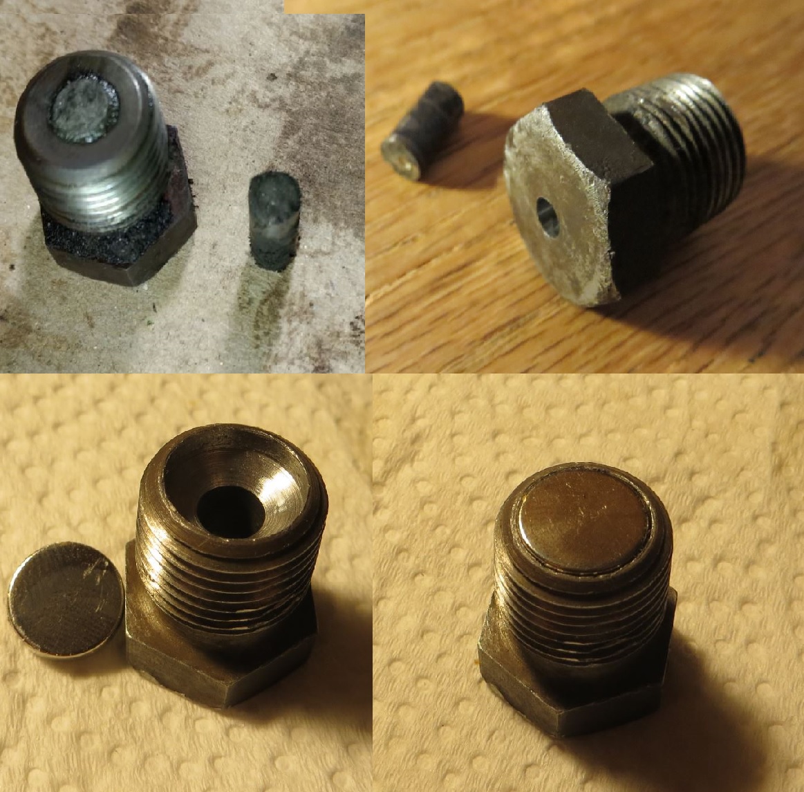

Just a thought because I've seen others do this with cars is to buy rare earth magnets and stick them to the bottom of the oil filter. 6 for $5 at Home Depot.
Also I drilled out an old drain plug and replaced the weak magnet with a good one then sealed it with JB Weld.
I like it. :thumbsup:
   / Kubota Hydraulic Filter? #5
Yep, I always stick magnets on my filters ... bought some long thin rare earth bar magnets about 3/8" wide, 3" long and just stick them to the side of the filter.
