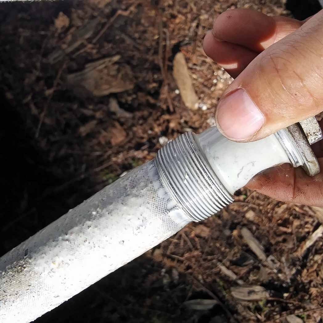

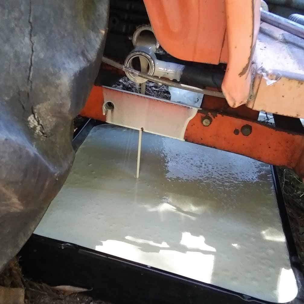

Just saw this thread.
You don't say where you are, but here on the left coast, I would sell that tractor with all those repairs for $9K with loader, even if it has gear trans.
I bought a cheap B8200 off a friend just a couple of years ago, and it had water in the oil, and needed some other minor repairs. Looked rough, non-working hour meter, and undesirable gear trans. I got it going again, but it still looked bad. Sold it to another friend, cheap. A month later, the hydraulics quit. Just before the friend's mechanic gives up and buys a new hyd pump, the problem is discovered: a speck of dirt in the RV.
Surprisingly, the hydraulics on the gear drive Bs of this era (late 80s) have no real filtration. Just a suction filter mesh. Ugh.
