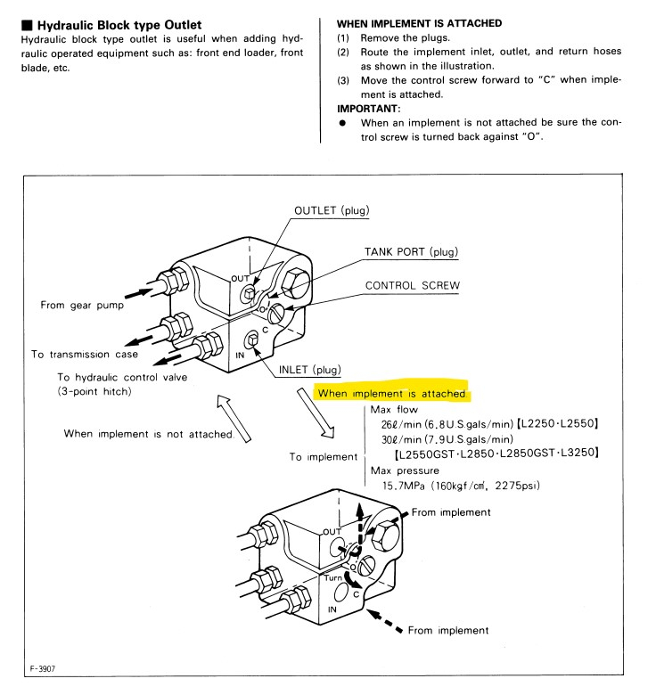

I have a Kubota l2550 with a model bf400G front end loader. I don’t know how to hook up the hydraulic lines to operate the loader. Cann anyone tell me how to connect them?

Look on page 26 of your Operator's Manual.
There should be a control block like this:
   / Kubota hydraulics #3
Does your loader valve have power beyond? The arrow "from implement," would be the loader valve power beyond port providing hydraulic flow back into the tractor system.
Not certain if you have power beyond. 6 hoses on loader valve means no power beyond. 7 and you have pb.
Most valves can have a pb adapter screwed in but you have to buy it
