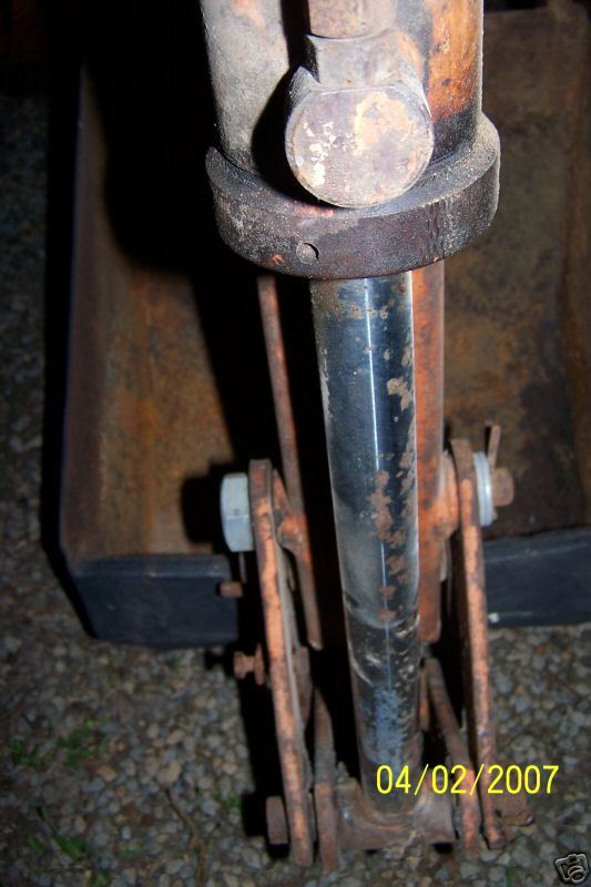

Wow! That looks great. You must have the patience of Job to undertake the rebuild. I noticed the rams were pitted pretty good, any leakage issues? Congratulations on your project well done, that backhoe will be mighty handy!!
   / Kubota K-650 Backhoe rebuild
Thanks for the kind words. The rams did look pitted however it was mostly just surface rust that was taken care of with steel wool and fine sandpaper. At this time there dosen't seem to be any leakage on them but I haven't really put any stress on them yet.
