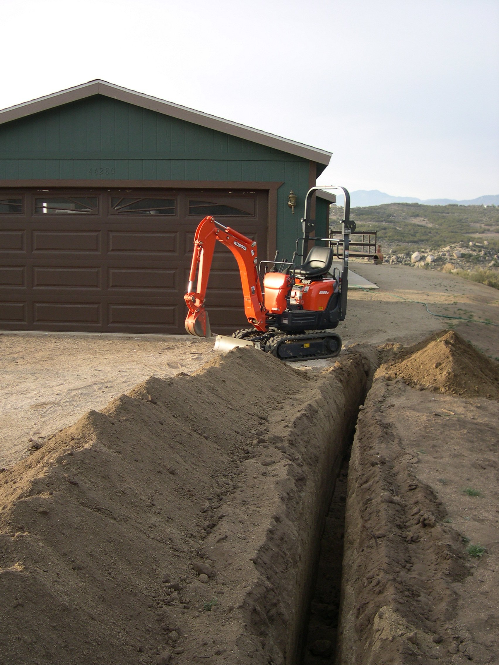

orangeelmo1, I have a K008-3. It is a great little machine. I have used it mostly to dig trenches....about 950 ft so far, anyware between 2-4 ft deep. Some of the ground is real hard and it takes some time to get though. Those are the times I wish I had something bigger. It is also great for lifting things and pushing things with the dozer blade. It is also very easy to transport. I have never owned a back hoe. I decided to get the k008-3 instead. I think it would be a hassel to move the tractor all the time and jump back and forth from one seat to the next. I like my tractor with the box scraper on it and would hate to have to drop the hoe and then put it back on. My tractor does a better job digging out trees than the 008. My NH TC40DA is abour 5-6K and that weight makes a difference. I paid 16100 for a new one about a year and a half ago. Hope this helps you.... here are few pictures

Trackks9, I have 122hrs on the 008. The mule is great for running around the property. I use it for working on fencing and load it with wood when I am cutting down trees. I have tried moving dirt around with it but it can't handle much. My tractor works better for dirt moving. How do you like your Gator?
