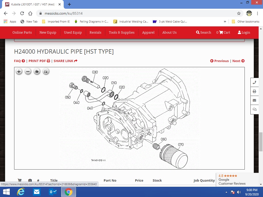

I've changed all of my filters and am not sure where the screen is located My manual has a small diagram. I am not sure how to access it. I cant find a better diagram. Thanks in advance
   / Kubota L 3010 hst hydraulic screen #2
Maybe this will help. They are from Messick's parts diagrams. Item 30 is the strainer. Item 70 is hydraulic filter. Will look like a bolt head on the suction line. On opposite side from hydraulic filter. My L3010 is a geared transmission which has no strainer so I cant help much. Good luck. Maybe post this in the Kubota section if this doesn't help.

Thank you. That's a better diagram. I'll try it tomorrow.
Thanks for the help. I was able to access the screen. It took up pry Bar to get it off and I made a new washer for it. Everything's put back together today and it out working. Thanks again
