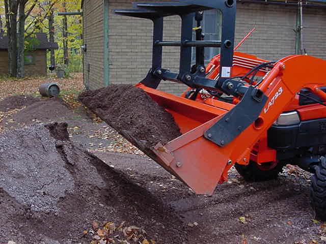

I used my L3130 HST w/723 FEL today loading crushed gravel out of a stockpile and dumping and leveling on one of my camp roads. Use 4 WD when driving into the pile, otherwise the rear wheels spin and rut (R4 tires). Had a 1952 AC WD w/Loader and trip bucket and just got tired of operating it (no power steering or live hydraulics). I'm no expert at loading, but able to get the job done. Attaching a pic of the average size bucket load I get.
penokee /forums/images/graemlins/smile.gif

I also have the L3130HST, LA723 loader and have been moving a tons of top soil and a lot of clay gravel fill, along with a lot of large rocks left over from building my new 40 x 60 shop last summer. All I can say is after more than 30 hours of loader work it been great. /forums/images/graemlins/smile.gif Steve
