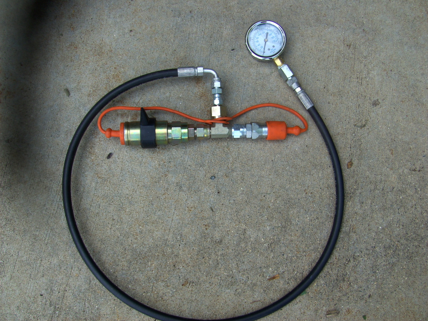

You can build yourself one of these for about $30.
As far as pressure, If you call Mesnick's Kubota, and ask for technical support, they will tell you the relief pressure setting for your tractor.
Kubota Parts | Full Service online retailer
If you do increase it, be careful as those pumps are not cheap.
At least, check it to specs.

JJ, as always, thanks for your help! This tractor is brand new, I bought it only a month or two ago. I've racked up about 60 hours so far, but its been weak like this since day one, so I don't suspect anything has changed since showroom condition. Do you think it was set too low from the factory? The reason I ask, I assumed I wouldn't be looking to adjust my brand new tractor to factory specs. I figured I was about to set out to push it beyond their preset limits. Or, according to the BX thread I ran across, they were talking about the specs being 1600-1800. So I could see that I might be towards the lower end of my factory spectrum. But several of those guys were pushing it up to 1900 or 2000 psi. I didn't see anyone that had posted back negative results, only people that liked how it had pepped up their hydraulics. I'm not assuming at this point that these are the numbers for my tractor, just using them as a reference. Are you suggesting that this would be too much, or be risky? If so, HOW risky?
