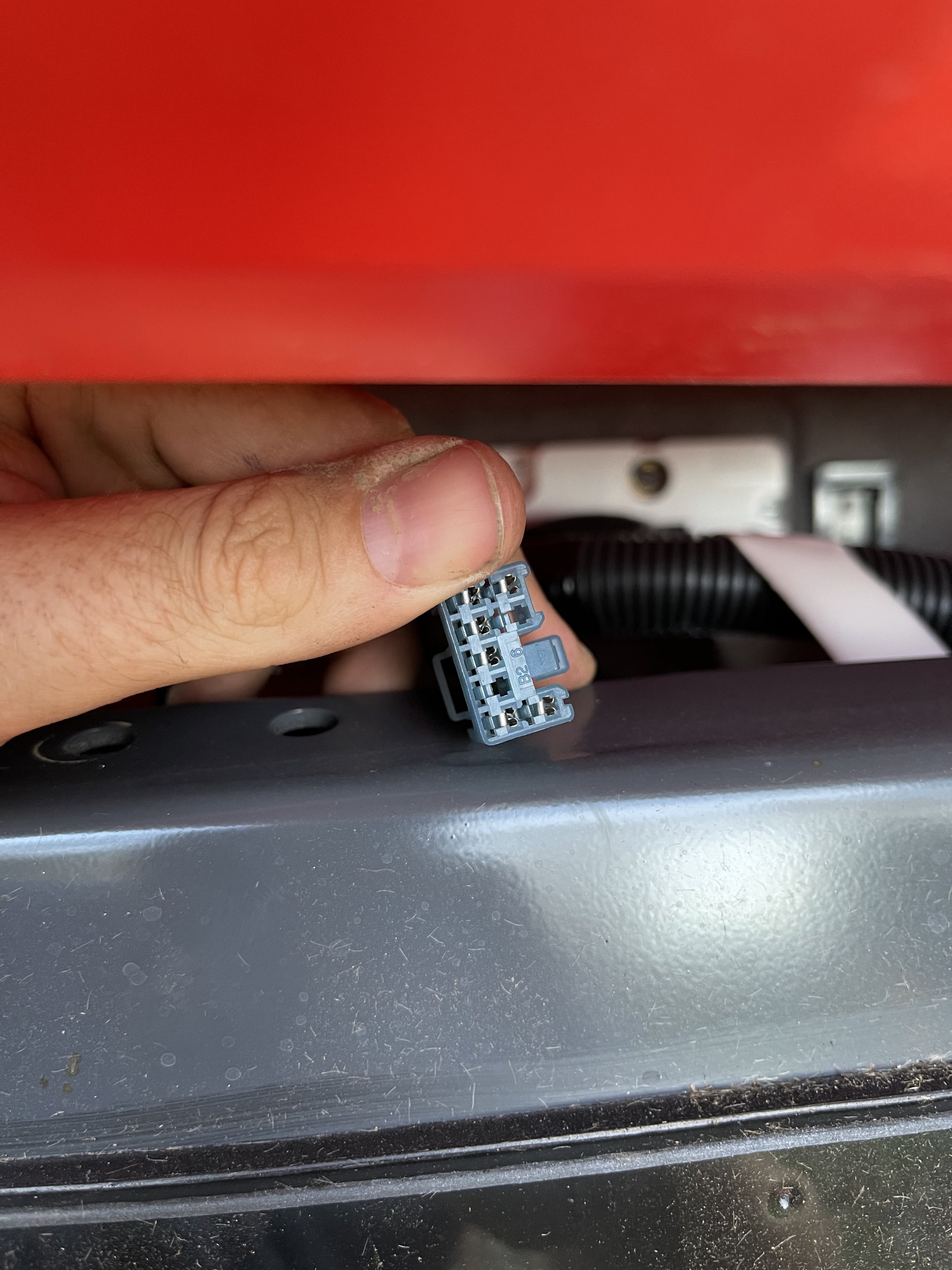

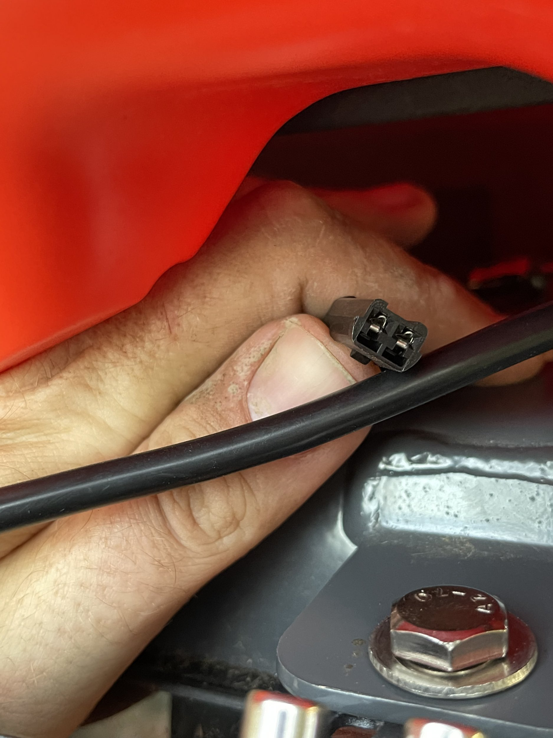

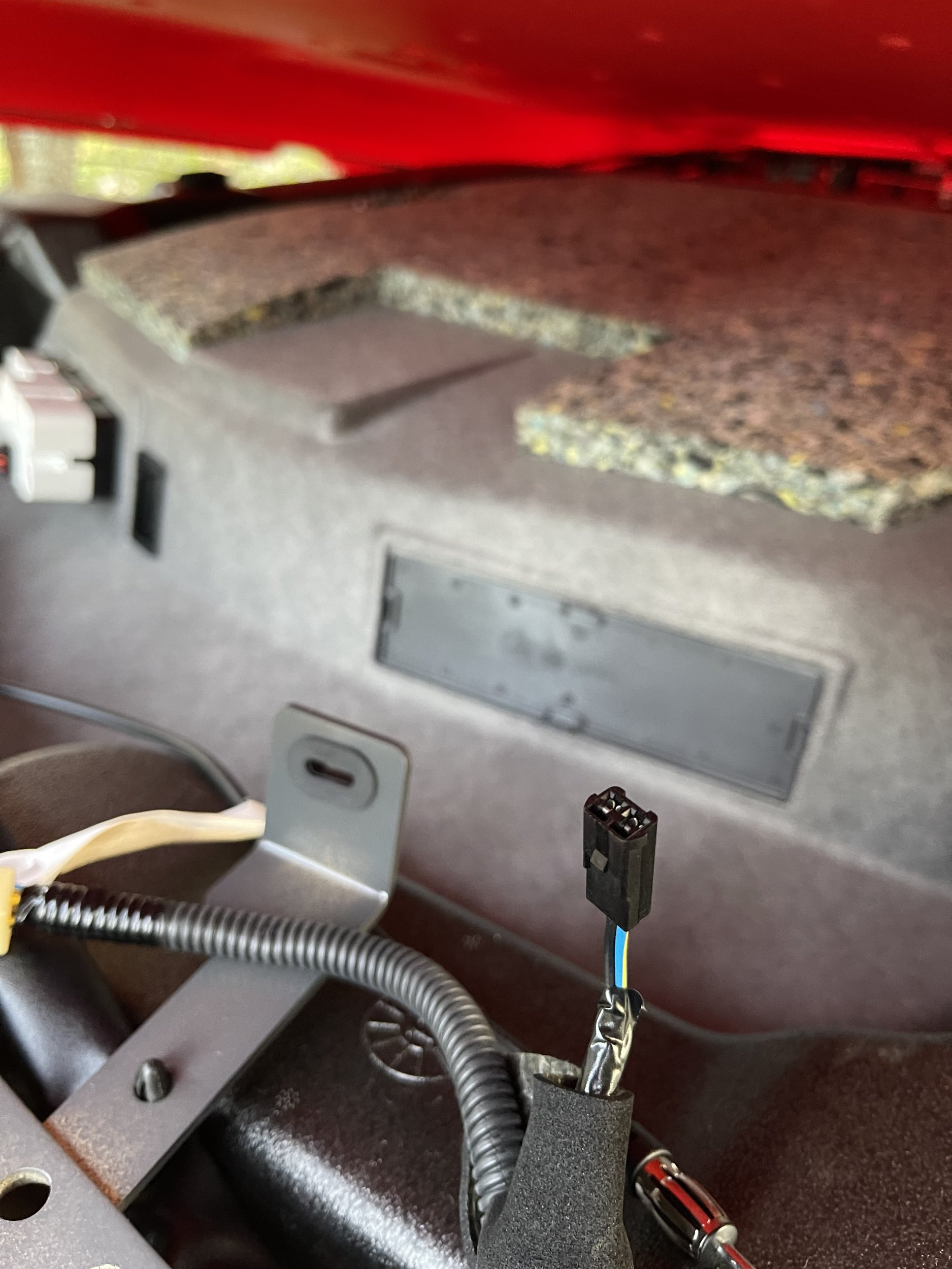

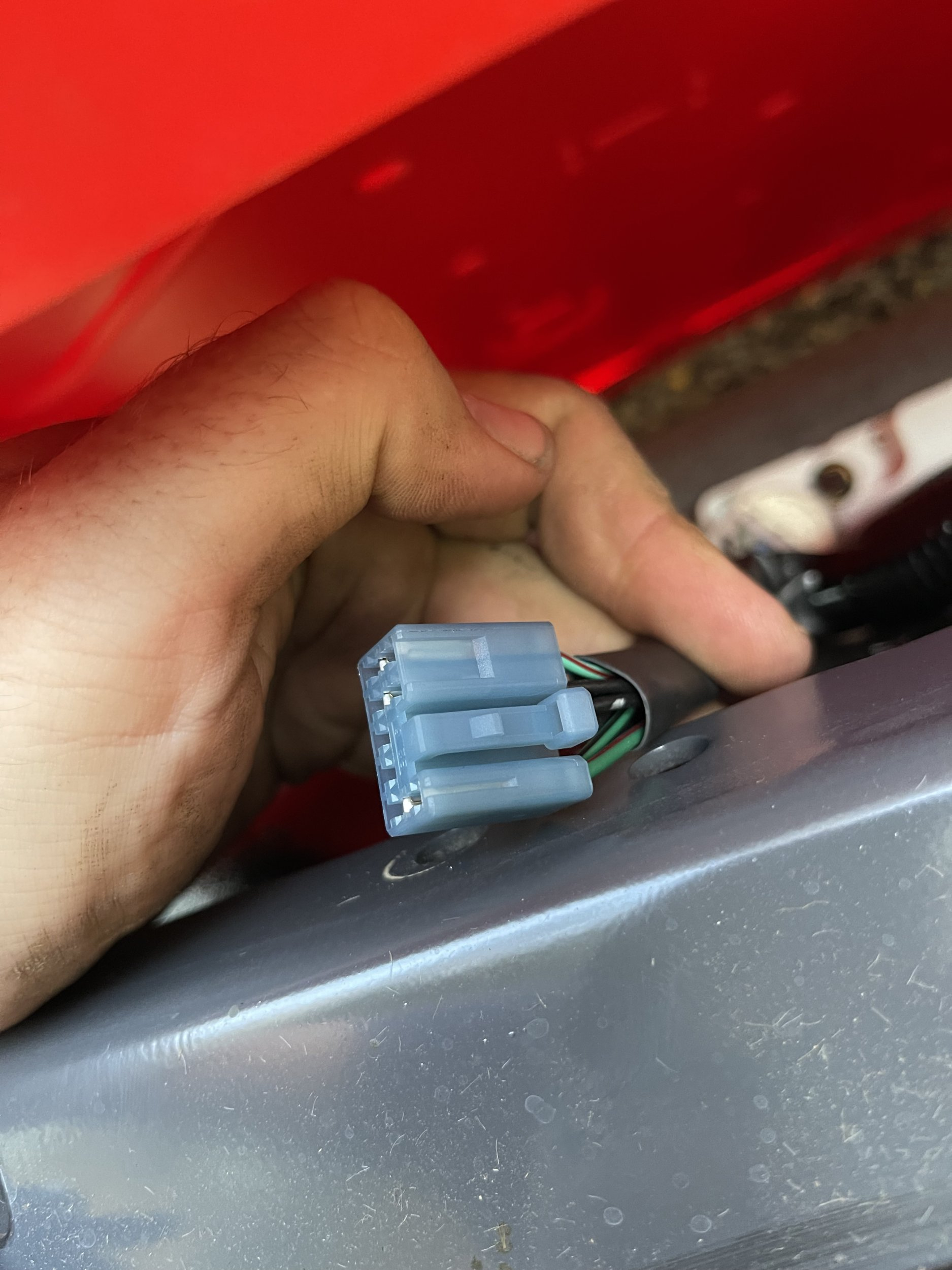

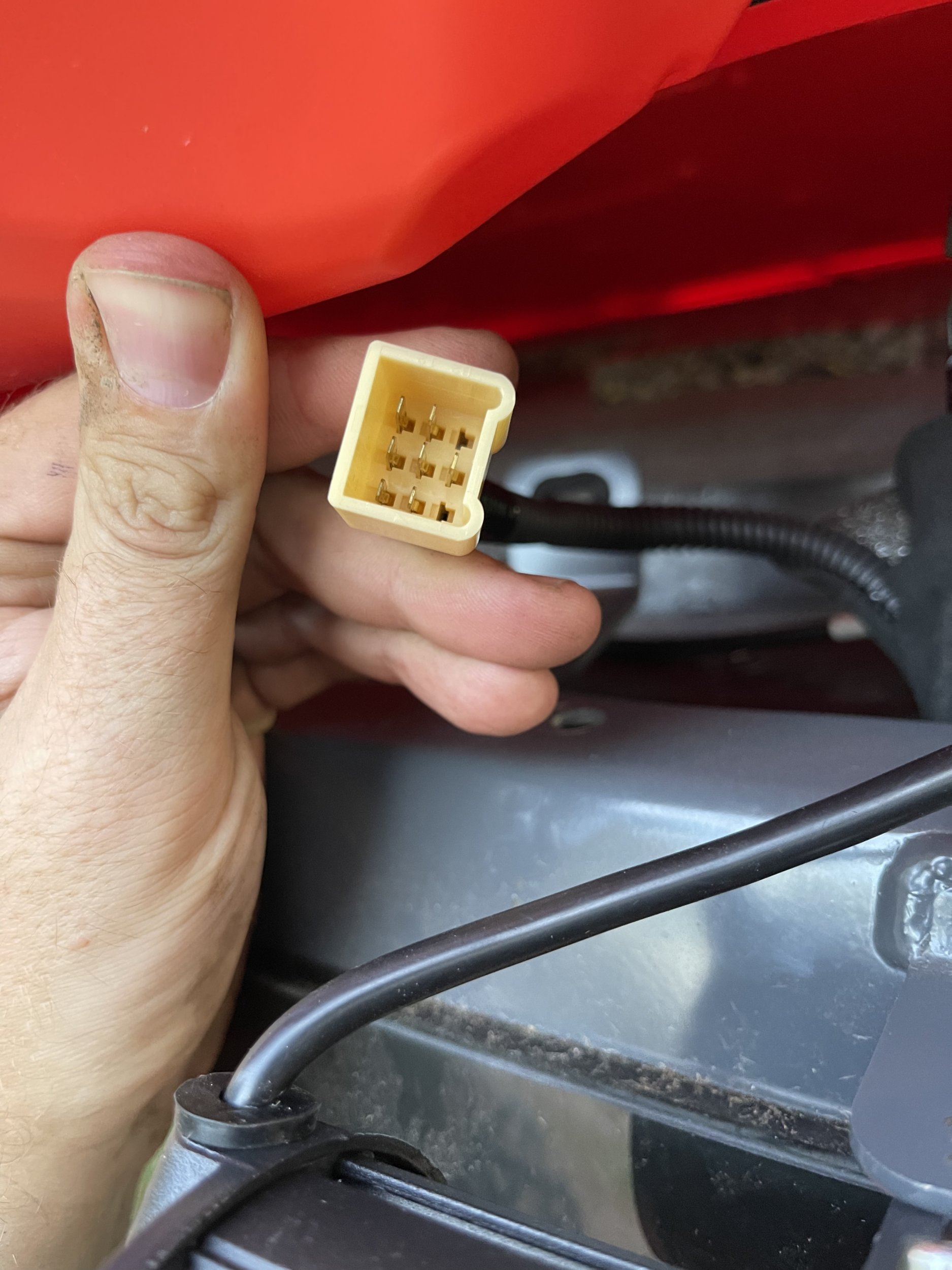

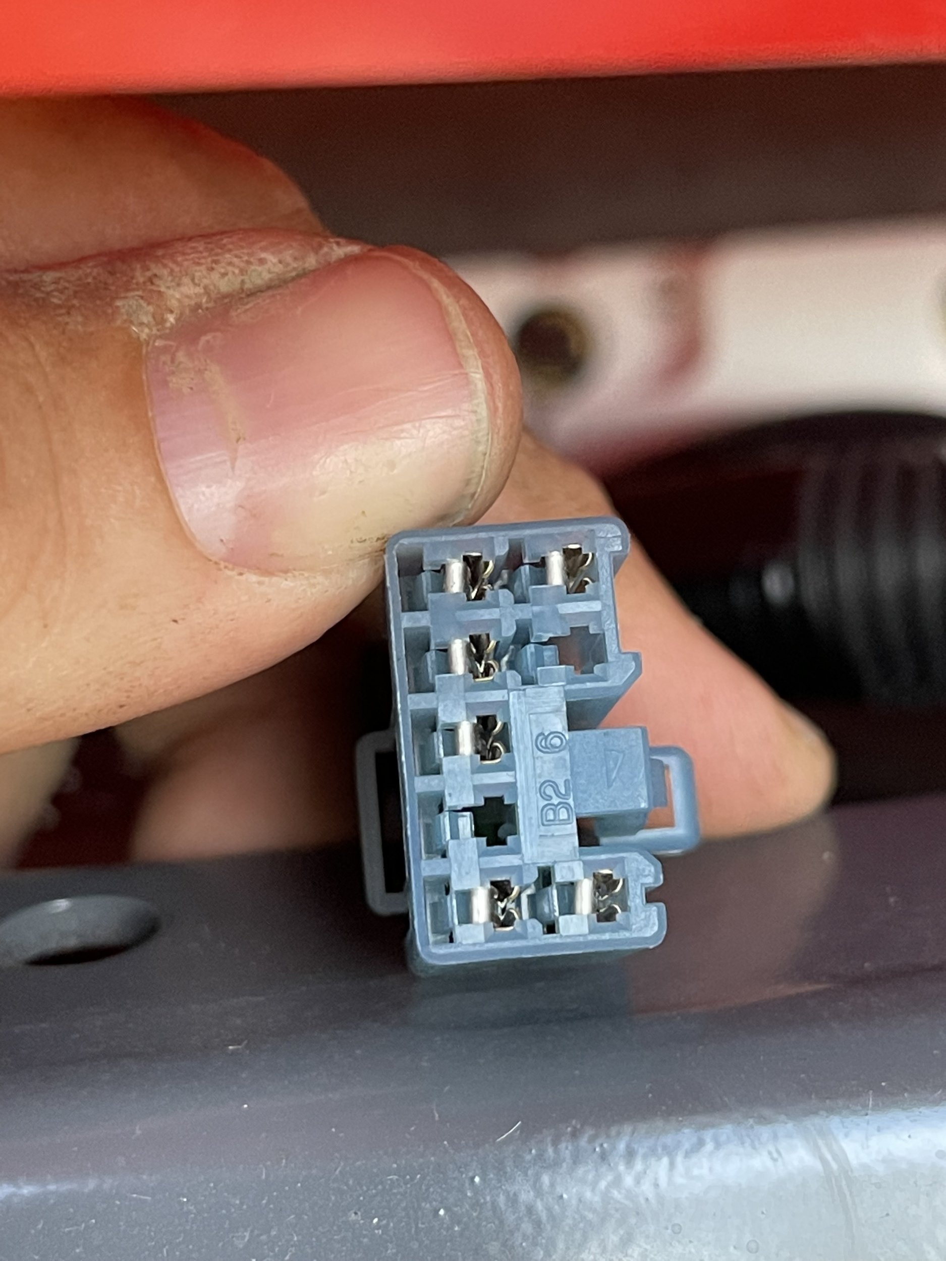

I've tried looking for my answer in the search bar but haven't found it. I'm adding LED lights to my L3560LE and I'm curious if anyone knows which of these pictured connectors is the correct one for the work lights. My lights mount fine on the front, need to find a bracket for the rear ones. At any rate, thanks in advance for answers.

Image 0232 is one of the light switches I believe. There are 2 switches, 1 for front & 1 for back. Both are located in the pillar next to the loader joystick. Should be wired the same.
The skinny 2 pin plugs up in the roof are the connectors for the lights.
0235 is the plug for the radio.

Thank you!

Your owners manual should have a wiring diagram with color codes and wire sizes
A multimeter helps too
