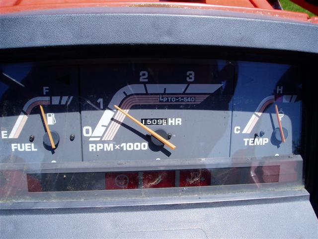

L3650 is overheating both at idle and when working. Temp indicator goes about 7/8 way to red. I replaced the thermostat and fan belt. Radiator fins are clean outside. Inside some (30%) thin white scale. All tubes open. No leaks from water pump, but there seems to be no flow from the engine into the radiator. Temp of coolant at top of radiator measured with a candy thermometer was barely 150F when tractor temp indicator was near red. I boiled the thermostat before installing it and it works fine. Could the pump be bad with no other indications? Or could there be something else about the thermostat I don’t know? No immediate indication of head gasket leaks or cracks- no bubbles in coolant, no excess smoke when under load. I’ve owned this 15 yr tractor about 6 months. Thanks, Hal /forums/images/graemlins/confused.gif

Is the temp gage accurate? Is the engine actually getting hot?
If it is overheating some of the normal problems are: Thermostat bad or installed upside down, Radiator plugged up, Radiator cap not holding pressure, Lower radiator hose collapsing or the water pump not circulating coolant.
From what you have said I would suspect the temp gage or sender may be bad… What is the temp of the head when you show hot? KennyV.

Many thanks for the ideas. New sender now installed, overheats as always. No "gurgling" though on shut down. Ran backhoe 30 minutes and did not get to red, but within fractions of an inch of it. Gage seemed still to be rising so I shut down. Never got into red. Will again try candy thermometer in top of radiator after heating up with cap off.
Any idea what degree equivalents are on the thermostat?
I guess bottom of red line is 212 F.
If coolant at top of radiator is real hot, then radiator may clogged. I've got Prestone cleaner in now, soon to be drained.
If coolant is not real hot then either 1)pump impeller is not up to speed or 2)temp indicator is faulty.
There are indeed no other water pump symptoms.
Sleuths: in going through the box of stuff that came with the tractor, I found a receipt from 2001 for a thermostat! Thus I suspect the overheat situation has been around awhile. The seller used the backhoe to dig a drainfield, but thereafter it was used mainly for gardening chores, not heavy, hot work.

Hey Airdriver - any news on the overheating situation? If it's not too late I'd like to change my recommendation to take off and inspect the water pump. It may come to that but it would be easier to check the radiator first.
Maybe you could try disconnecting the hoses from the radiator and running a garden hose into the top connection to see if full flow comes out the bottom. The flow should come barreling out the bottom right away - if it ponds up in the top tank or seems slow starting to come out, or runs a long time after taking the hose out, then not enough tubes are passing flow. If questionable, take the radiator to a shop for rodding out or new core.
