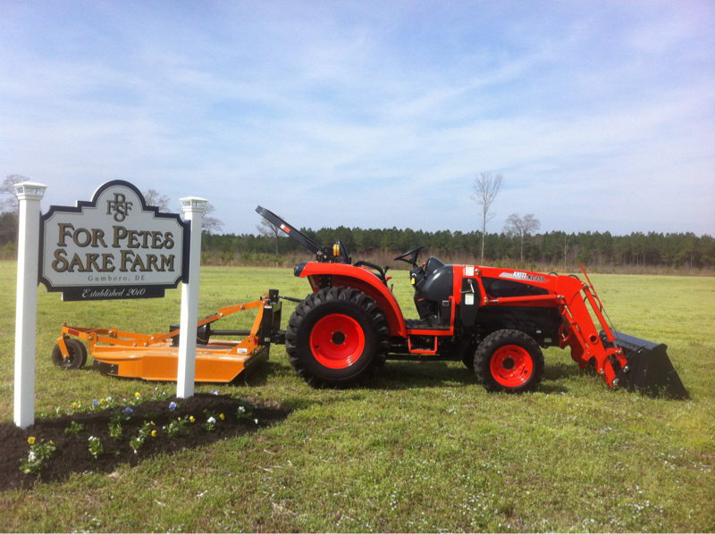

Thank you guys for your input! I made my mind up on the kioti and a woods bush hog, tiller, pallet forks and rear quick hitch! David A Banks in Georgetown was the dealer, great sales from mark and great service from lee and stu in the shop!
