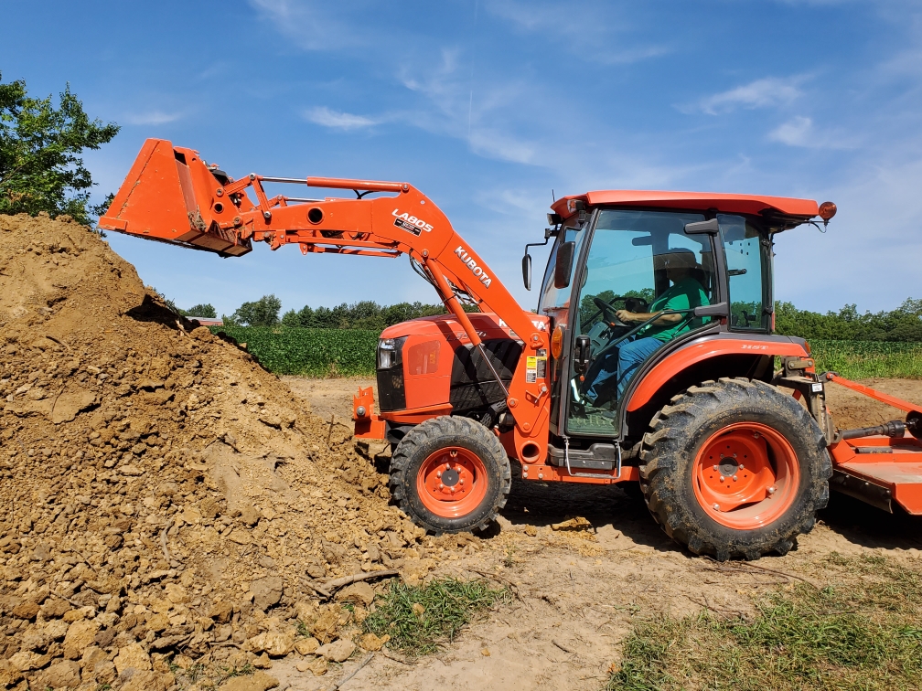

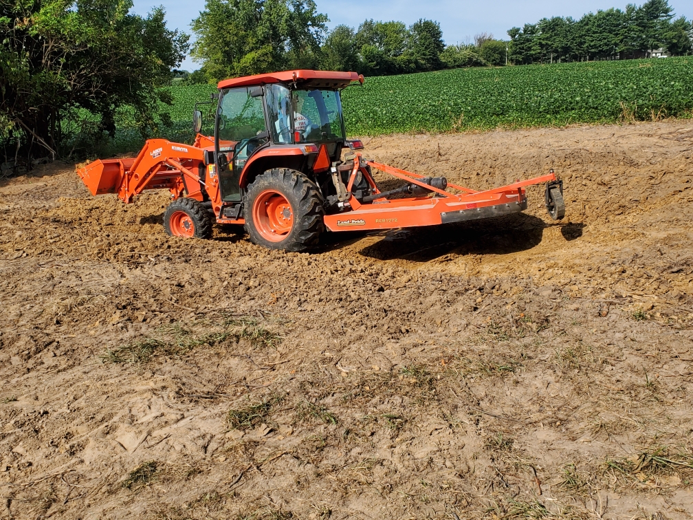

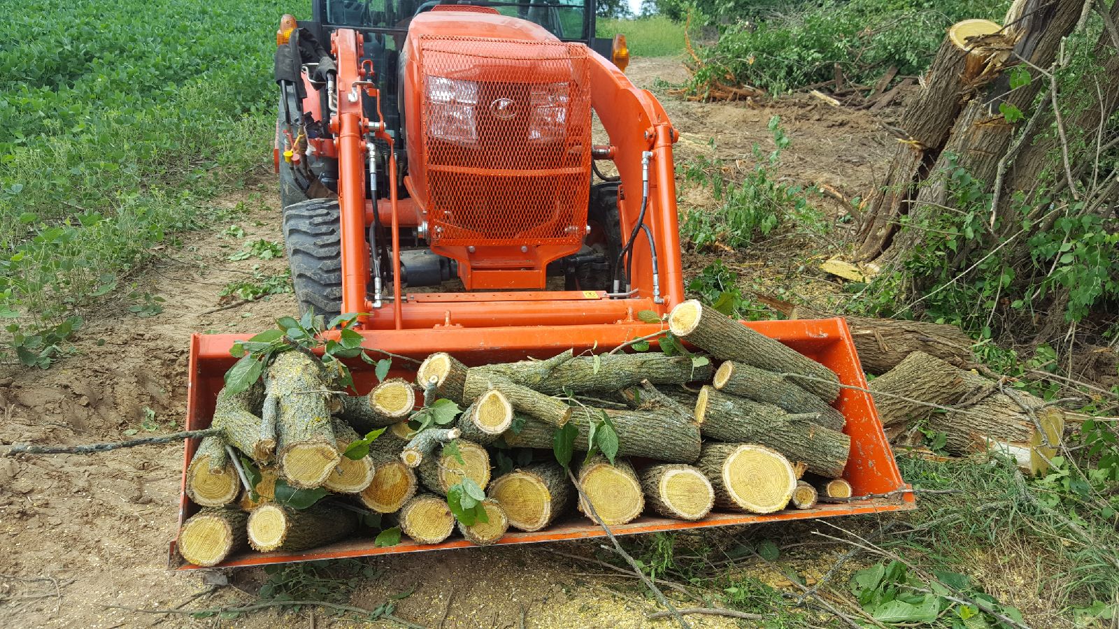

The extra weight in the L4060 I think would be helpful. I also have an L3560 and it has the same loader as the L4060, the LA805. My unit has a cab and weighs 3880 according to Tractor Data. I know that if I am using the grapple to pull some of the yaupon holly bushes we have, in certain circumstances, the backend can get light even with a 900 lb cutter on the back. I think the NH would require a lot of ballast if the loader will lift the rated capacity. With that said, either tractor would be a nice unit.
