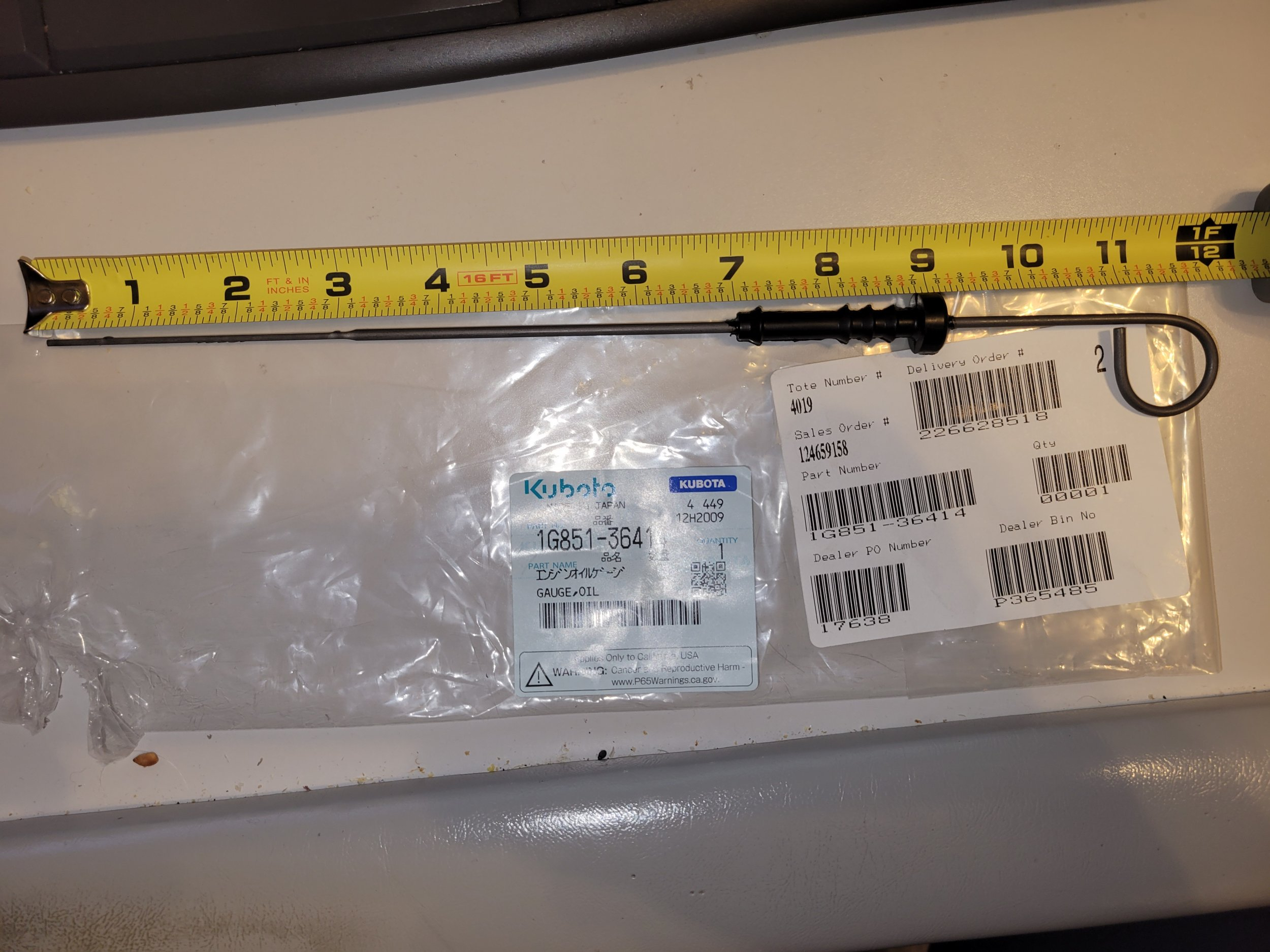

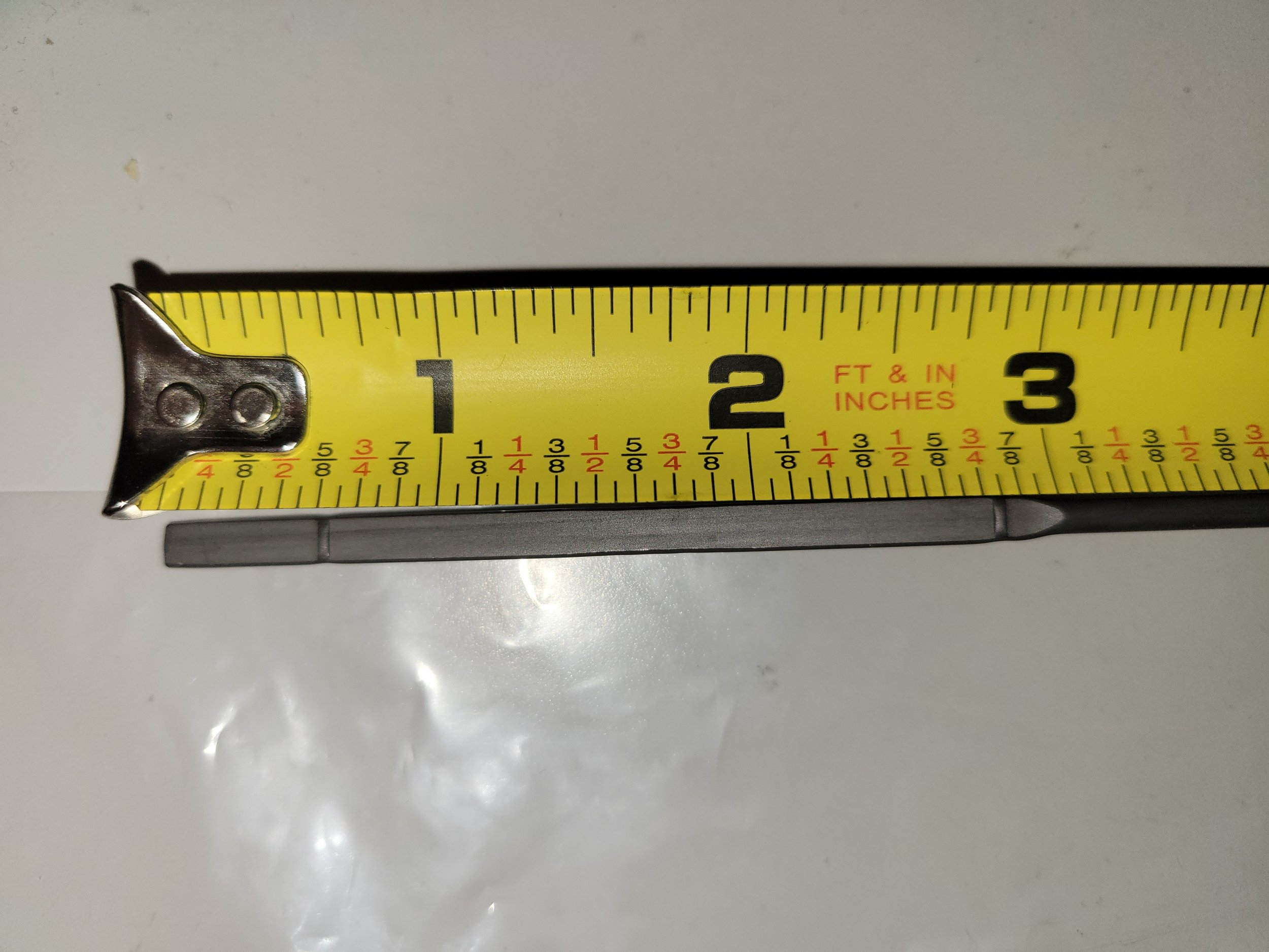

If anyone is ever looking for part# 1G851-36414 Guage-Oil (aka engine oil dipstick)... I managed to lose mine in the brush and had to order a new one. I'm liking to pretend that I didn't seat the thing firm enough and it blew out into the brush but I couldn't swear by it.
Here are the measurements:
Overall dipstick length - 8-7/8" from measuring end to rubber stopper at the top. 12" long including the finger pull.
  • oil measurement lines (low) 9/16" and (high) 2-7/8" from the bottom end
