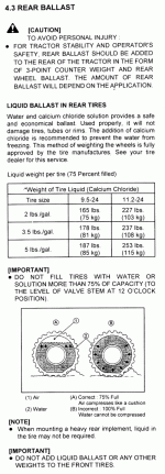

Paula -
When I first started looking at tractors, I was surprised to find out that the loader wasn't an integral part of the machine. Guess the only ones that ever caught my attention up to that point were the ones with loaders on them.
The point is that the loader is indeed an add-on, and part of the complete installation and prep is to make sure the weight distribution is dealt with, as others have already pointed out here. If you bought new, you should have received a separate manual for the tractor and the loader.
I've attached a relevant excerpt from the loader manual that came with mine. It's from the section labelled, "PRE-OPERATION INSTRUCTIONS".
This was just the beginning of my now on-going education about tractors.
