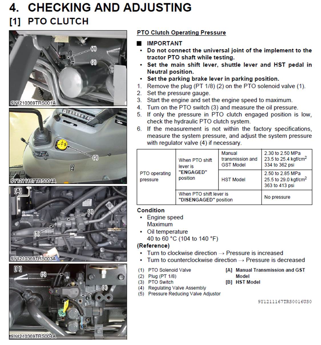

Kubota L4740 PTO will not shut off, tractor has 170 hrs, I split tractor to remove PTO clutch pack, clutch disc and steel plates welded together, clutch pack shows heat present. Replaced clutch pack,seals gaskets,filters and fluid. Kubota repair manual describe's checking and adjusting Pressure Reducing Valve. I purchased a digital pressure gauge, specs show PTO engaged, Eng, @ Max speed, you should have 334 - 362psi, I have 280psi. I only use this tractor for plowing snow and the PTO for spreading cinders from a HERD spreader, the PTO clutch has been slipping from day one, using the PTO spreader, I wouldn't notice any slippage until as it did build up heat and weld the disc together. I have replaced all parts and adjusted the Pressure Reducing Valve to 350psi, and have over $1600.00 in bills and many hours labor for a problem that I had no control over.

Where did you get the pressure specifications? I see a different pressure specified... 363-413 psi vs. what you reference, 334 - 362psi
See attachment.
Added in edit...
Further research indicates there are different set pressures for the PTO depending on if HST or not. The HST is set to 363-413 psi.

I purchased the service manual when I received the tractor, the specs you have are they for a L4740-3..... You have me wondering now about the pressure, I have mine set at 350psi, but when moving the tractor (HST) the pressure drops. Does your manual have the year of publication?
   / Kubota L4740 PTO, Check the pressure #10
Year of manual is Feb 2015 and it is for all newer GL40's.
According to the Kubota's parts website it looks like L4740-3 and smaller use 6 clutches/steels in the clutch pack, while the L5240-3 and larger use 7. I'm wondering if you could have used the 7 clutch/steel clutch pack to get more torque capability.
Do you think the HST requires higher pressure to compensate for the lower pressure when moving? How much does it drop when moving and does it ever recover?
