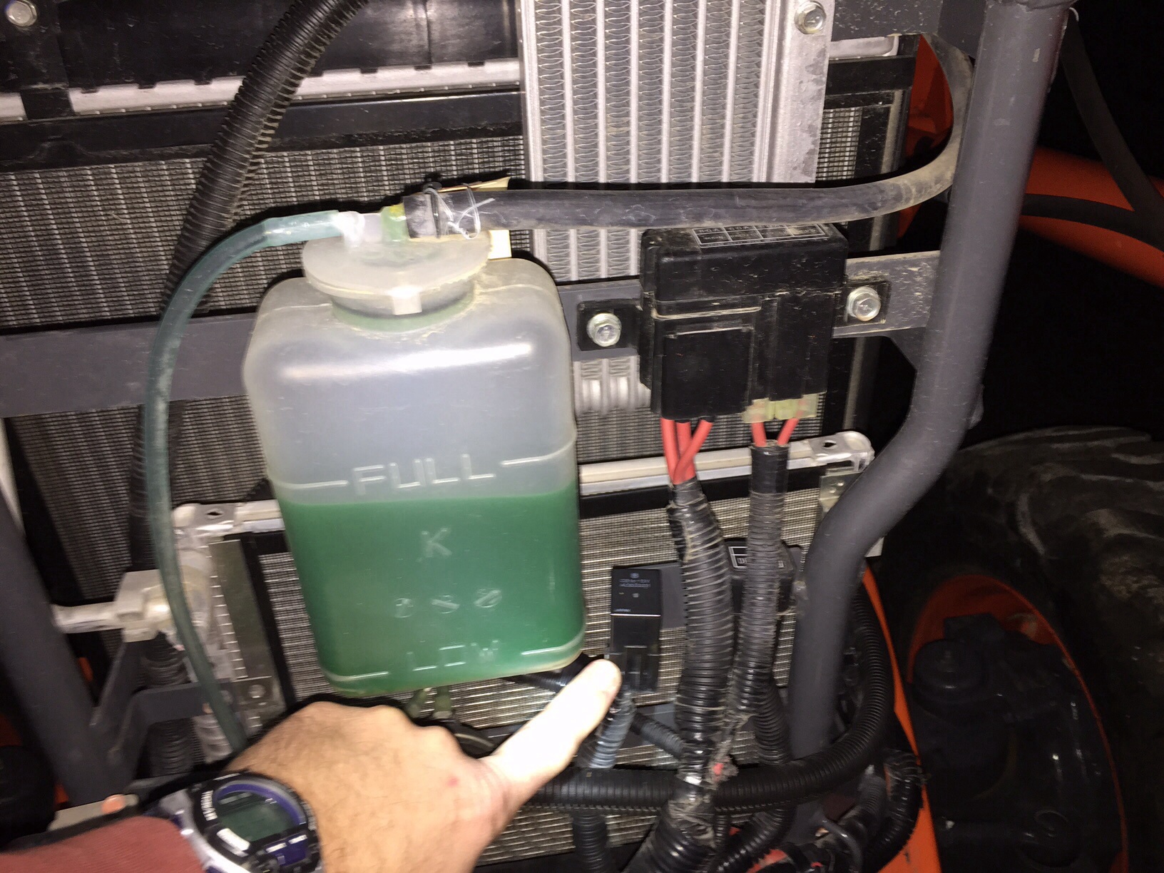

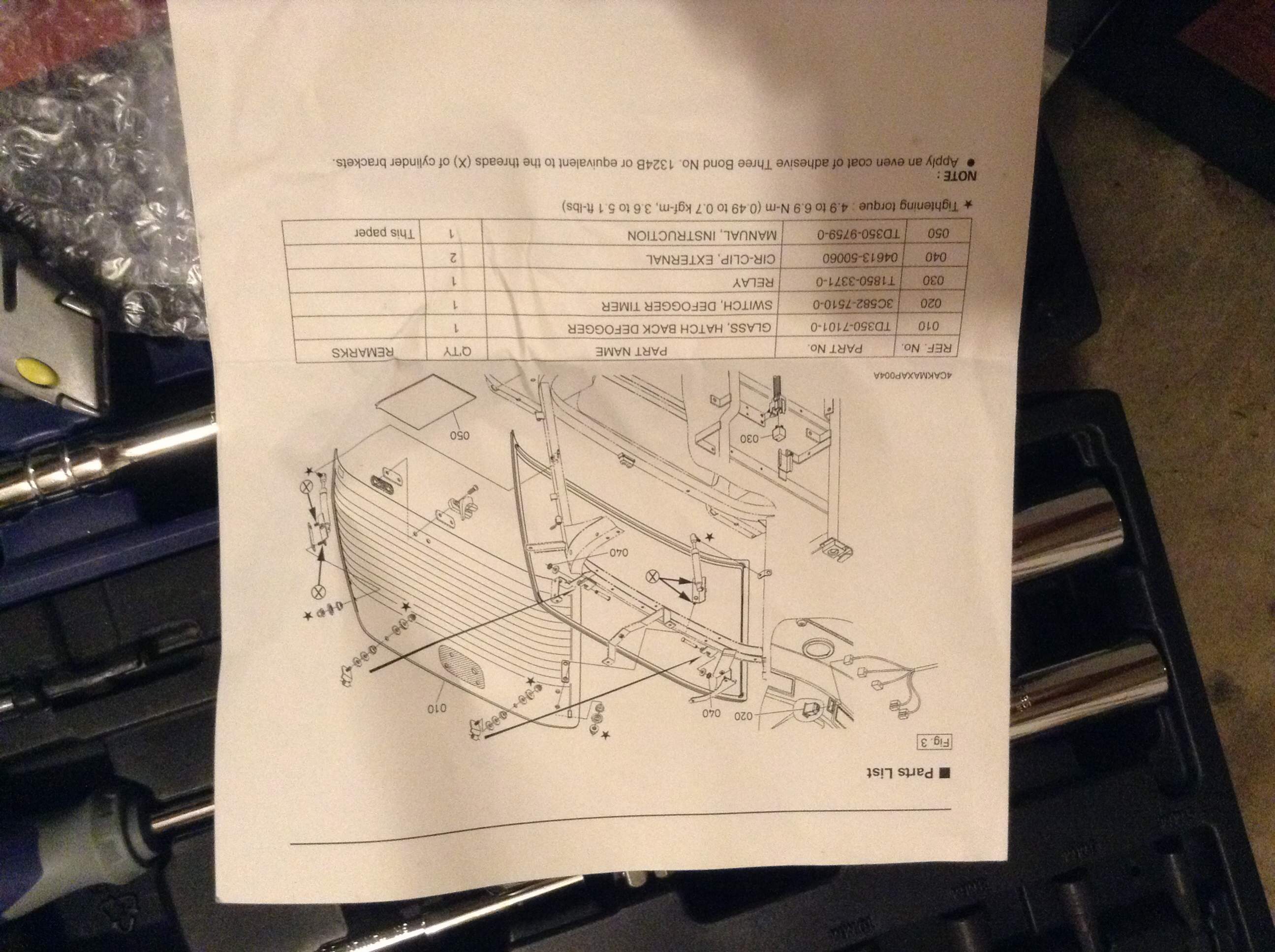

Greetings all. It's been a while since I last posted. Just picked up a new to me grand l5460 cab tractor. I bought the rear defrost glass and am in the process of installing it. I can't find the location where I am supposed to install the relay. It is item 30 in the picture. There is no reference to what the view is. Thanks in advance

I think it is the radiator support bracket by battery. There is a fuse block there.
David Kb7uns
   / Kubota l60 defrost relay location?
David
That is exactly the spot. Thanks a million! I was tearing apart the headliner, apparently in vain.
Photo below for future reference.
