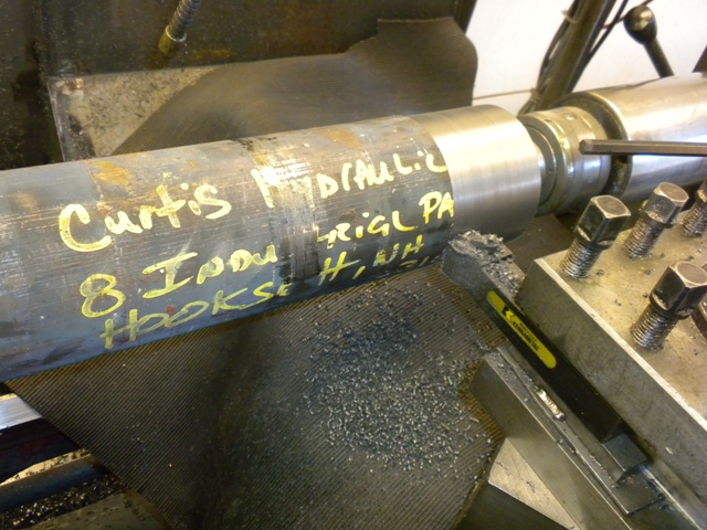

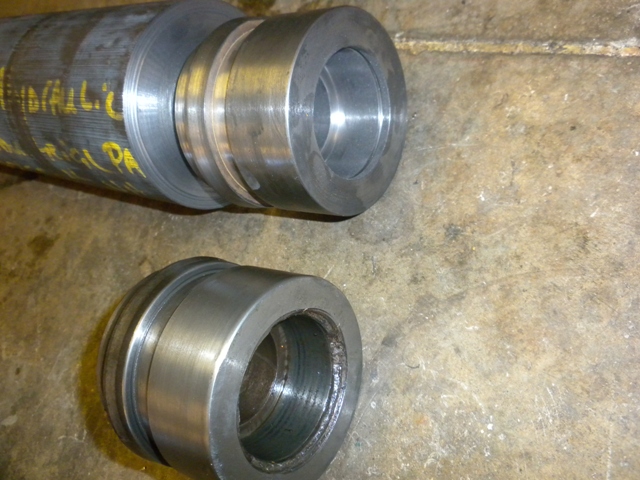

   / Kubota LA450 FEL Gland Nut Cracked #6
Yours would look different, but making one is not impossible.....maybe not cost effective for you, but not impossible......
