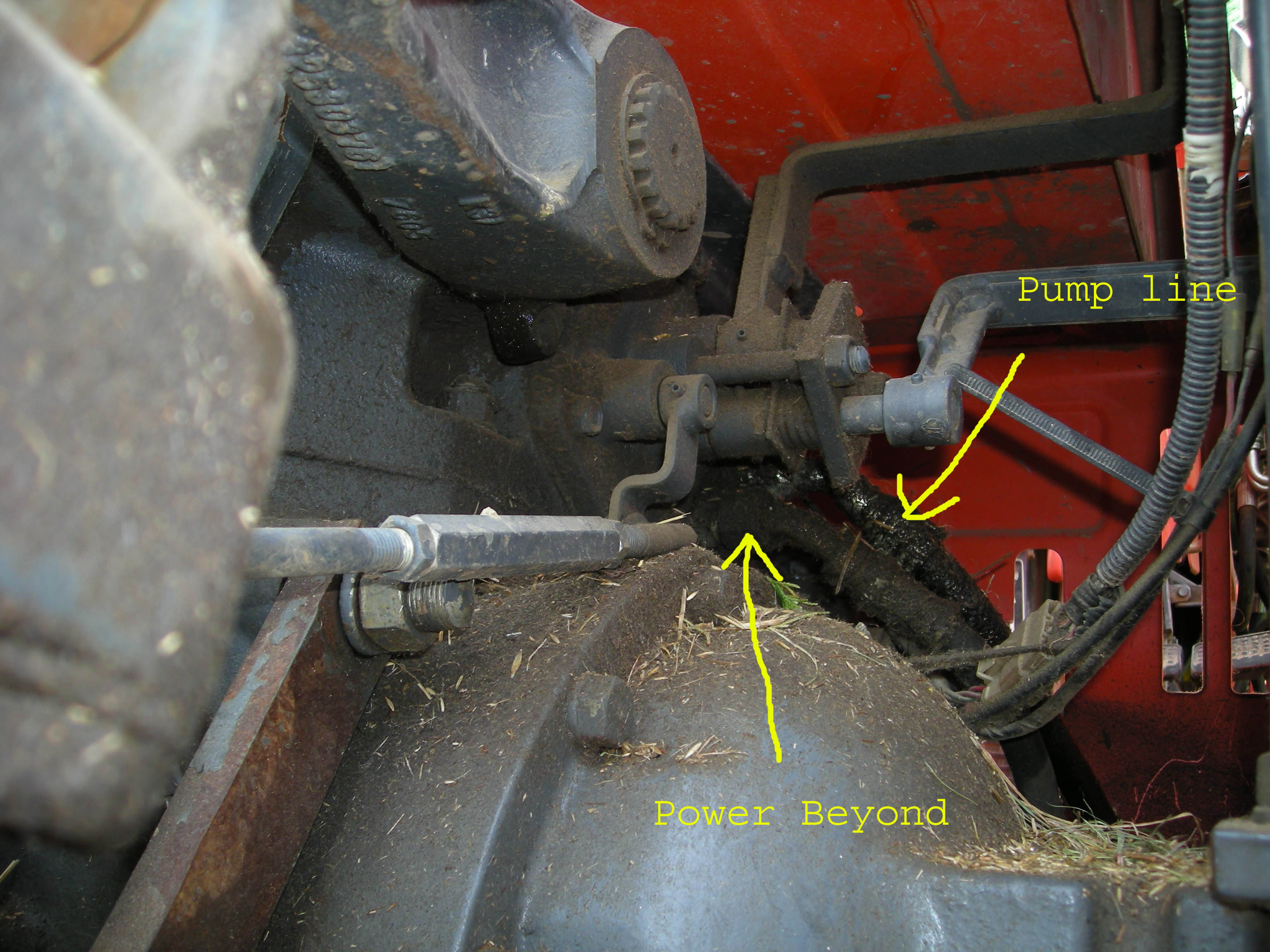

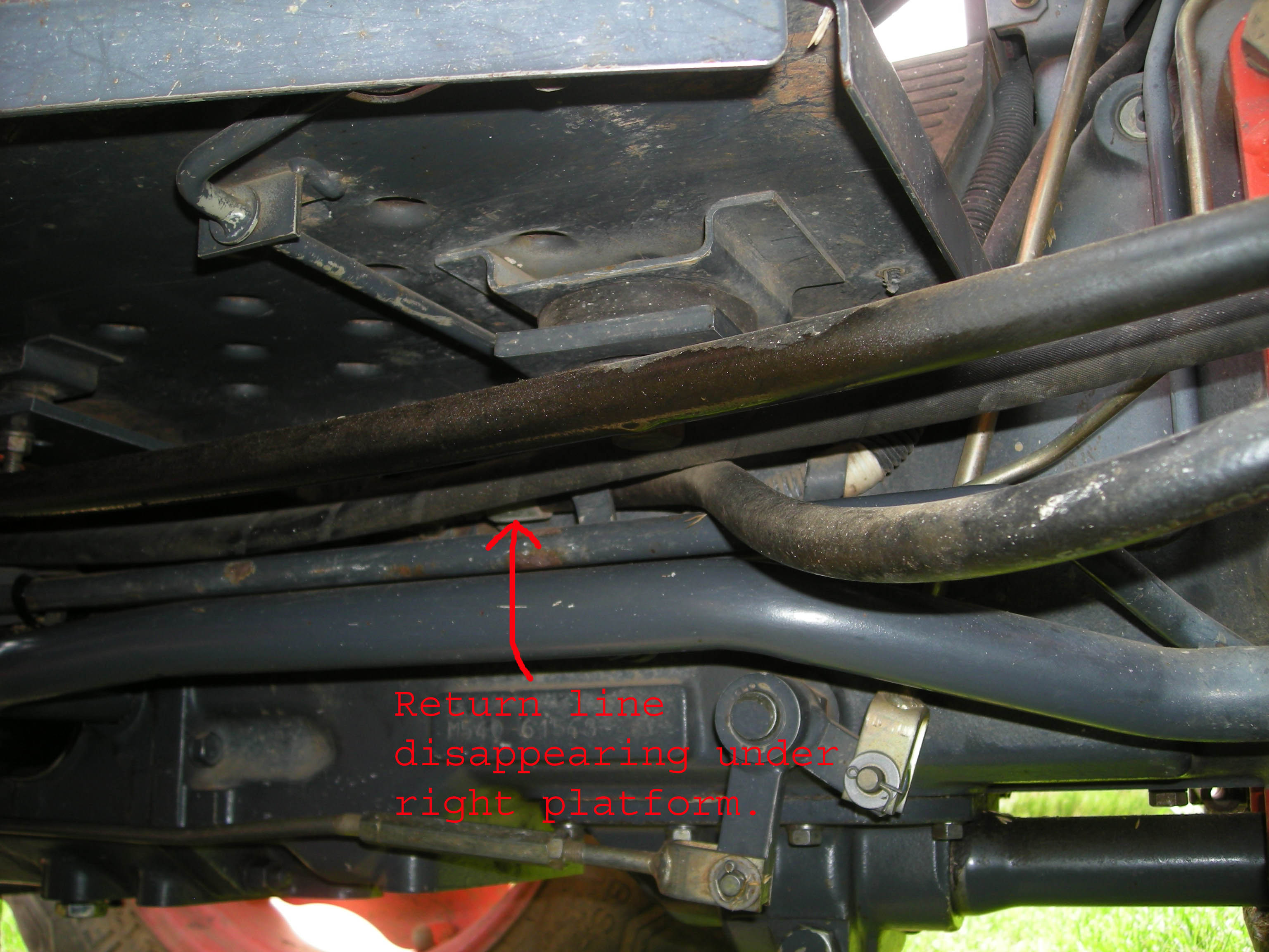

I am trying to answer a question from another member but I am not sure if my answer is correct. I am going to post here in hopes of being corrected if I am wrong.
Based on the connections to the loader, the following appear to the the connections to the tractor.
One view is from the right side with the return line connected beneath the platform.
The other view is of the right rear showing the power beyond line and pump line attached.

trying to upload pictures again. .
