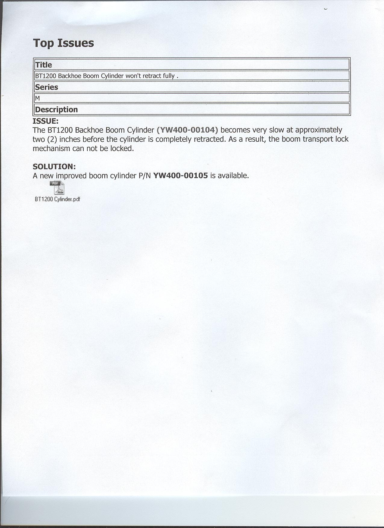

I don't know that all of them had the boom cylinder problem, but some did and word is that they are good about taking care of it. When mine did the same thing, Kubota warrantied the cylinder and sent a guy out to replace it. About an hour job. Since it was about a month out of warranty, I had to pay for the hydraulic fluid that was lost.
The old style cylinder was part YW400-00104, the new improved cylinder is YW400-00105.

CG, that's real interesting - thanks for doing that post. It matches what I heard from the Kubota rep which was that the nut that holds the piston to the rod hadn't been locked down properly when the cylinder was originally assembled. So eventually it would back off the threads and jam against the bottom of the cylinder - shortening the stroke so that the main boom wouldn't raise up enough to engage the travel lock claw. That sounds like exactly what your rebuilder found.
If so, that's a bit scary because it means as the nut backs off the BH is going to continue to work normally except the boom can't be locked to travel - which is OK until that nut finally works it's way completely off the cylinder rod and the whole boom falls without warning. I remember that we continued to use mine for a week or so before calling the dealer to describe the problem, and then continued to use it until the new cylinder came and was installed. Being pretty sure what was going on, we were careful not to let anyone get under it in case it suddenly failed.
I hope that anyone with any backhoe that has either boom cylinder not fully closing will take a moment to think about the consequences of a failure there. In fact, that's a lot of why I'm writing this post today.

I'd guess that for safety issues this obvious they didn't want the liability. But I wonder why they didn't replace all the cylinders in all the 2008 models? Kubota certainly know who the owners were - it was a brand new model and there weren't that many of us. Wouldn't you like to have listened in to their boardroom discussion!
Anyway, it's a known safety issue and a serious one. So you either ought to get the new part via the bulletin below.... or have your local hydraulics shop fix yours. And be very careful until then - there won't be any warning if it lets go.
That's been the sole downside to the M59, and as I said - Kubota was apparently very quick to fix the cylinders that they knew about. It's been long enough ago (about 2011) that it's not surprising a dealer wouldn't remember.
