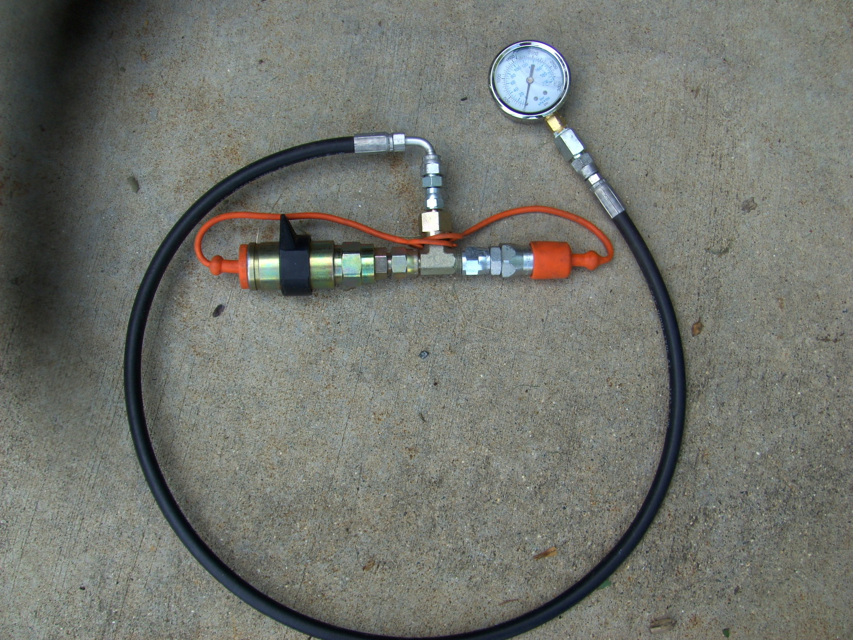

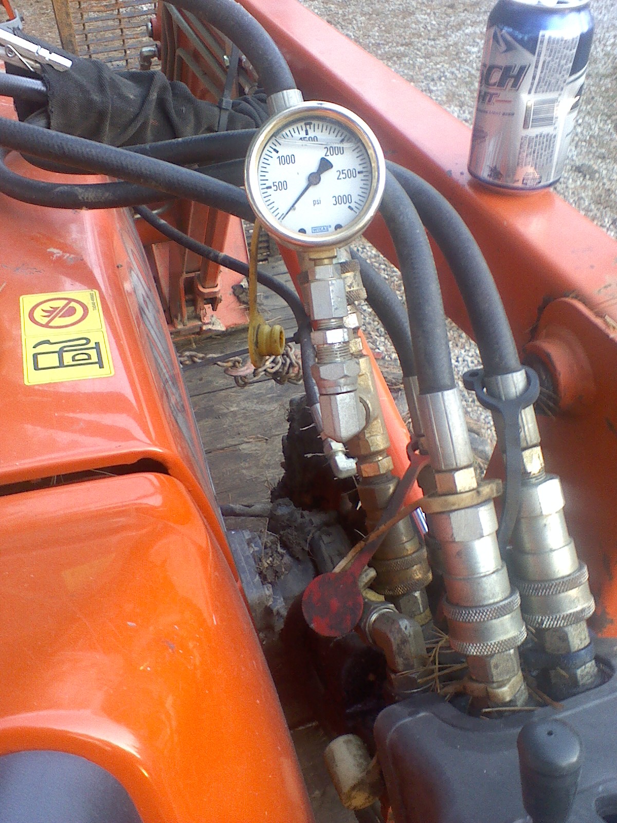

If you want to know if the 3pt valve is causing any pressure, then install a hyd gauge in a tee in the IN port of the FEL valve.
With all valves in neutral, there should be no or very little pressure indicated.
When you use any hyd valve, cyl, or motor, the gauge will indicate the pressure.
You can also use the gauge to monitor and troubleshot the hyd system.
Hyd gauge set should run abut $30 to $50.
