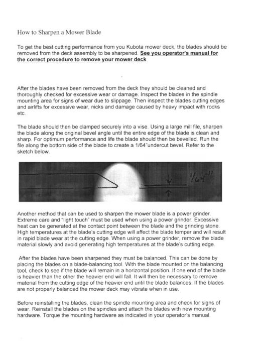

I found this on the Canadian Kubota website a while back.
I never saw the undercut recomended anywhere else.
Mike
   / Kubota mower blades
That is an interesting idea Mike. When I removed the OEM blades, I was surprised to see they were a bit wider than the Kubota replacement blades. The replacement parts are ground at a single angle, a bit sharper than the originals. The originals, being perhaps a quarter inch wider are ground at a lesser angle and then a second bevel is cut on the last eigth inch of the cutting edge at quite a sharp angle, almost opposite of what your attachment shows. On my machine, this edge did not hold up well and until I removed them from the machine last week, could not get a good look at them. I will sharpen to remove the second angle and return to a conventional blade, seems to work better.
