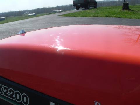

Hi Everyone,
I found a few tiny hairline scratches on the hood of my B7510. I want to fix them. The dealer said that I could spray some paint into the lid of the can and use an art brush to fix it. I just do not want to botch it up....any suggestions?

Are the scratches down to the metal or just hailine surface scratches?
Maybe a picture would help.
You might be able to rub them out (yeah copper rub you out see /forums/images/graemlins/grin.gif ) with some rubbing and polishing compound?? Maybe

Here's a before.

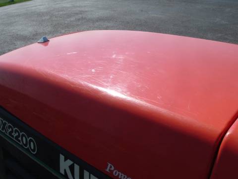

Here's an after. There's also a scratch remover called NP27, I'm sure you can find it with a search, like "As Seen On TV".

Dip the tip of a toothpick in the paint (thinned enough to flow into the scratch) and just fill the scratch level with the surface. Let the paint cure for about a week and follow with a good polishing compound. The technique may take some practice, but I think that you will have good results.
