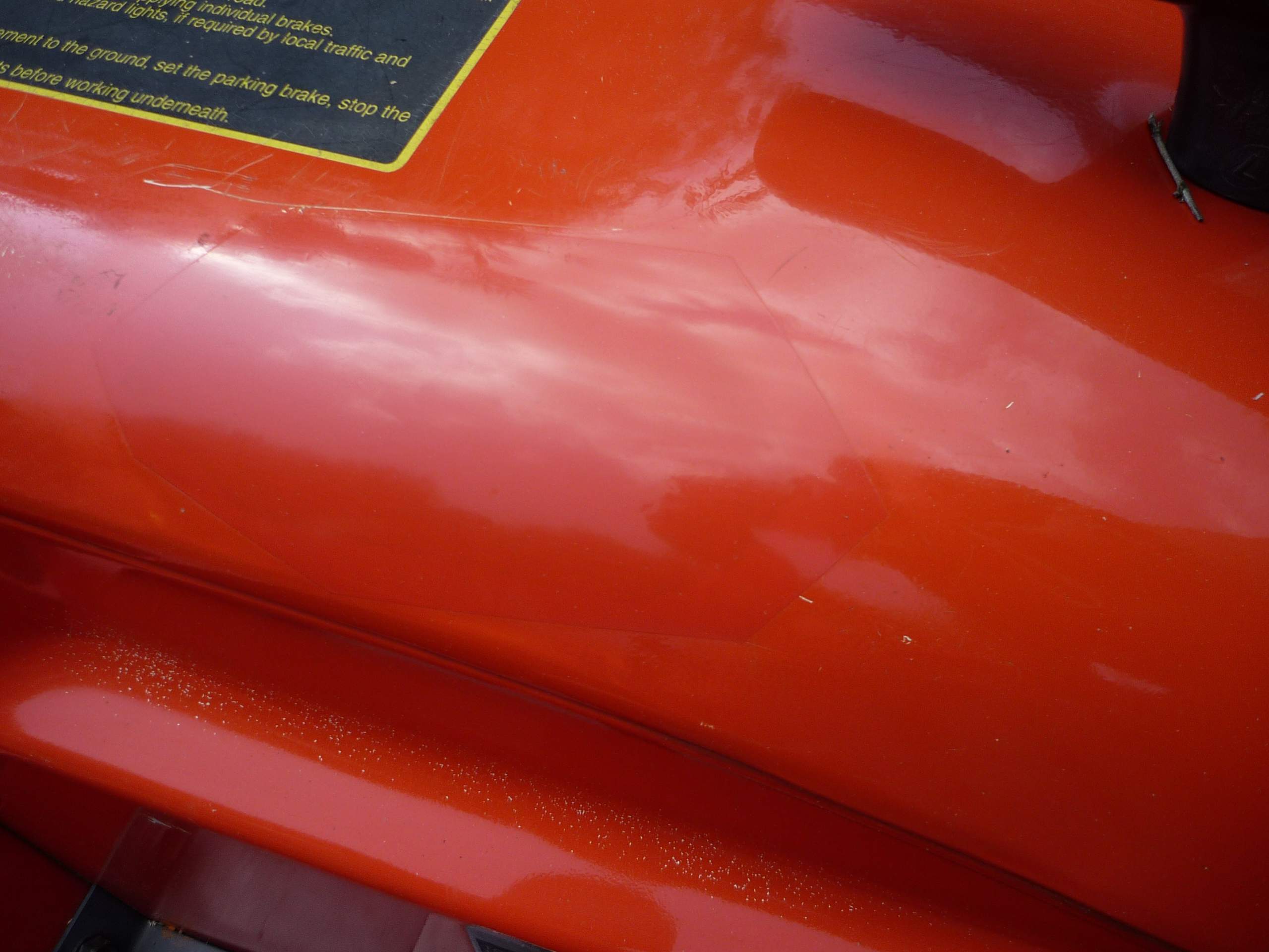

Search for paint in the Kubota forums, and you'll find lengthy discussions about color matching, etc. The Valspar paint, and one other brand that I forget, get bad reviews for quality. I think you'll find that those of use who have used the Kubota paint have been very happy with it. It sprays perfectly with a little thinning from xylene, and seems to hold up well! Any decent dealer can tell you what paint you need, but I think type II, or the "New" orange is it. Photo is a patch I painted on a fender, before buffing/smoothing masking lines. Sprays very nicely, as maybe you can see?
